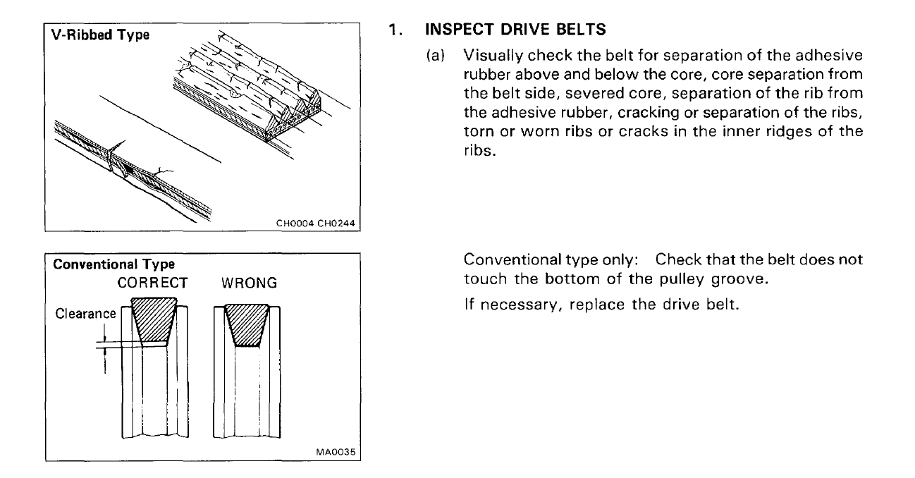

Above are good. However, ideally, the way Toyota designed it and recommends per FSM (attached) ...
New AC and New PS belts are the typical belts used "cogged V-belts". Belt circumference, width and shape of V have to be just right.
They should fit the pulley without bottoming out aka "clearance". They should not be to wide that they hit other parts on the side.
If you do not have exact part number, best to buy locally so you can easily return if they do not fit. Ask me how I know.
