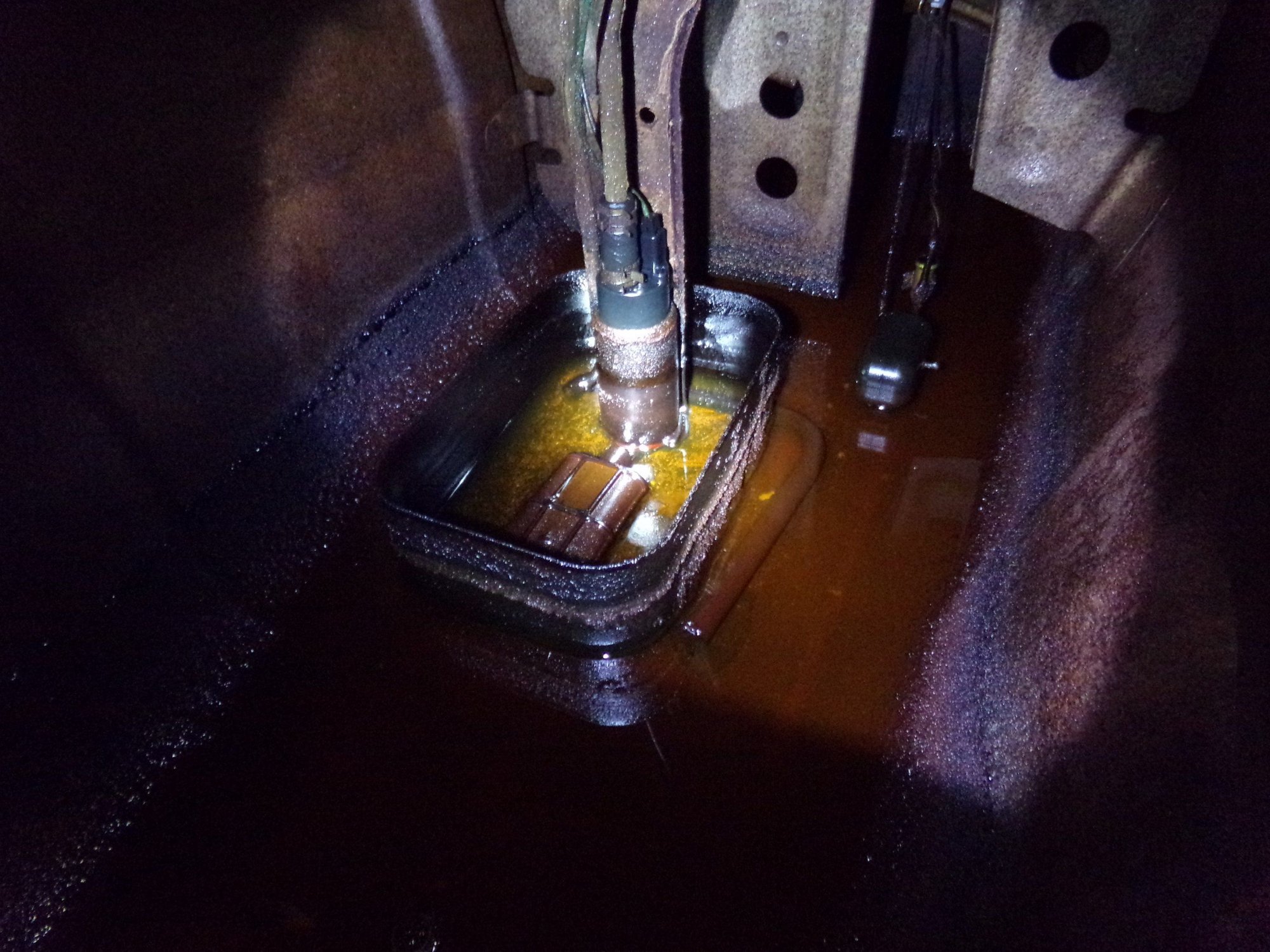

I ended up ordering a tank (from amazon - yes, I know - but it was $50 cheaper than next alternative). I had tried acid, etc. Gravel, screws, whatever for abrasive. did not do well.
Pic before attached.

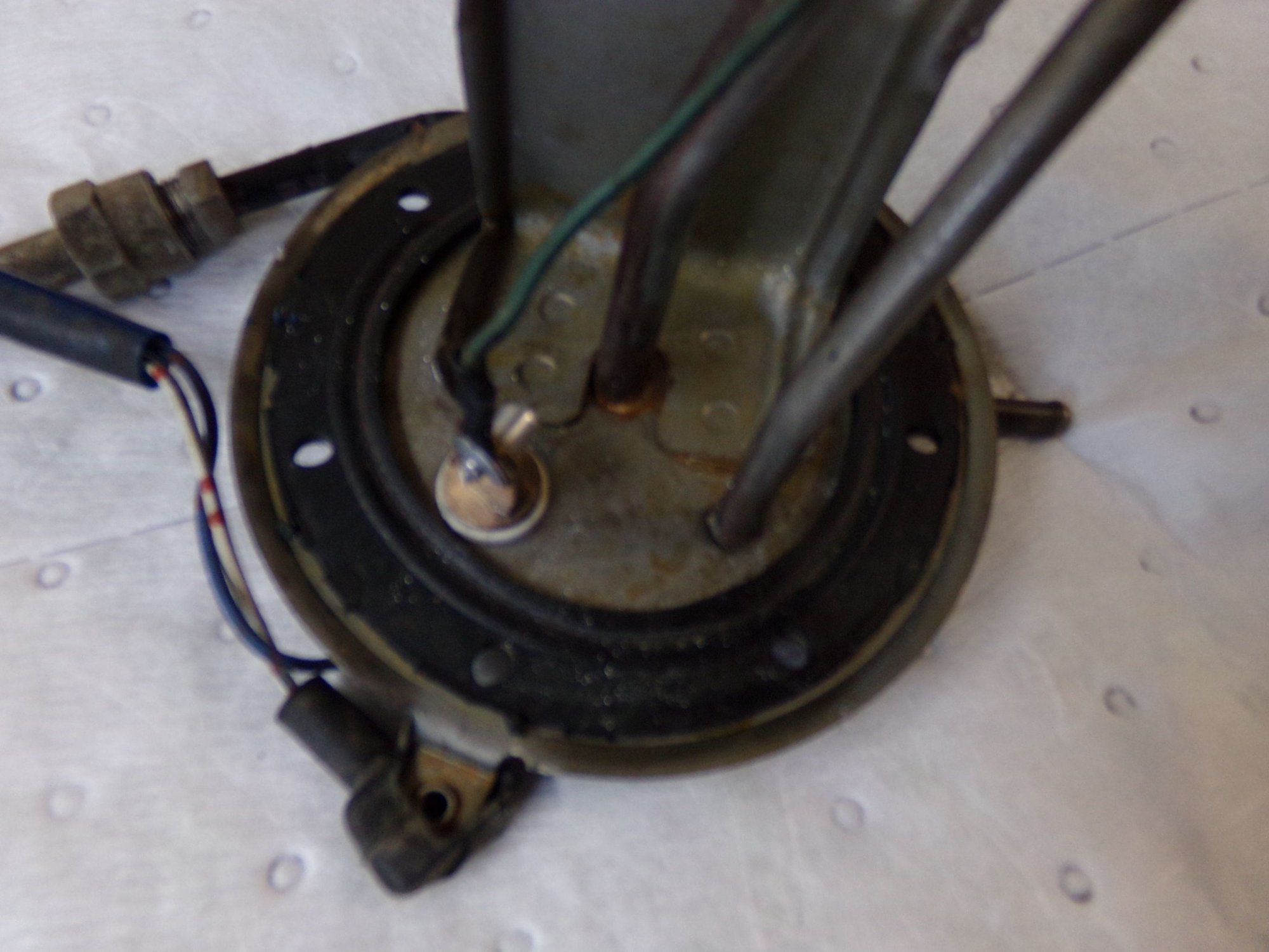

Few days later it occurred to me to try Muriatic acid (HCL). It was 33%. It works great on rust. Did not do so well on the tar like substance on bottom. That and the top of the tank, I just decided to go with new. I did manage to clean the pump bracket, the fuel return tube was completely plugged off.

Used a rivet to reattach the lead and ground wire for the fuel pump.
Inside of tank
Reattached wire

I had leads on getting original cleaned after the acid failed. And one thing I didn't note in posts (somewhere), aside from the safety! safety! safety! is after you're done, you MUST neutralize and dispose of the neutral properly. That takes effort (pH strips, etc). And one can't just dump it down the sink, even if neutalized. (Well, maybe in W Tx lol.) But the one shop in FC that used to do baths closed, and some folks around there said the last few times they'd looked into it, it was not worth cost even if someplace was near by.
The tank from that 99 was amazingly clean too. I know it was wrecked in early 2017. And was maybe 1/2 full? Which makes me wonder if something else wasn't going on with the 95 (other than it sat for nigh on 10 years?)
