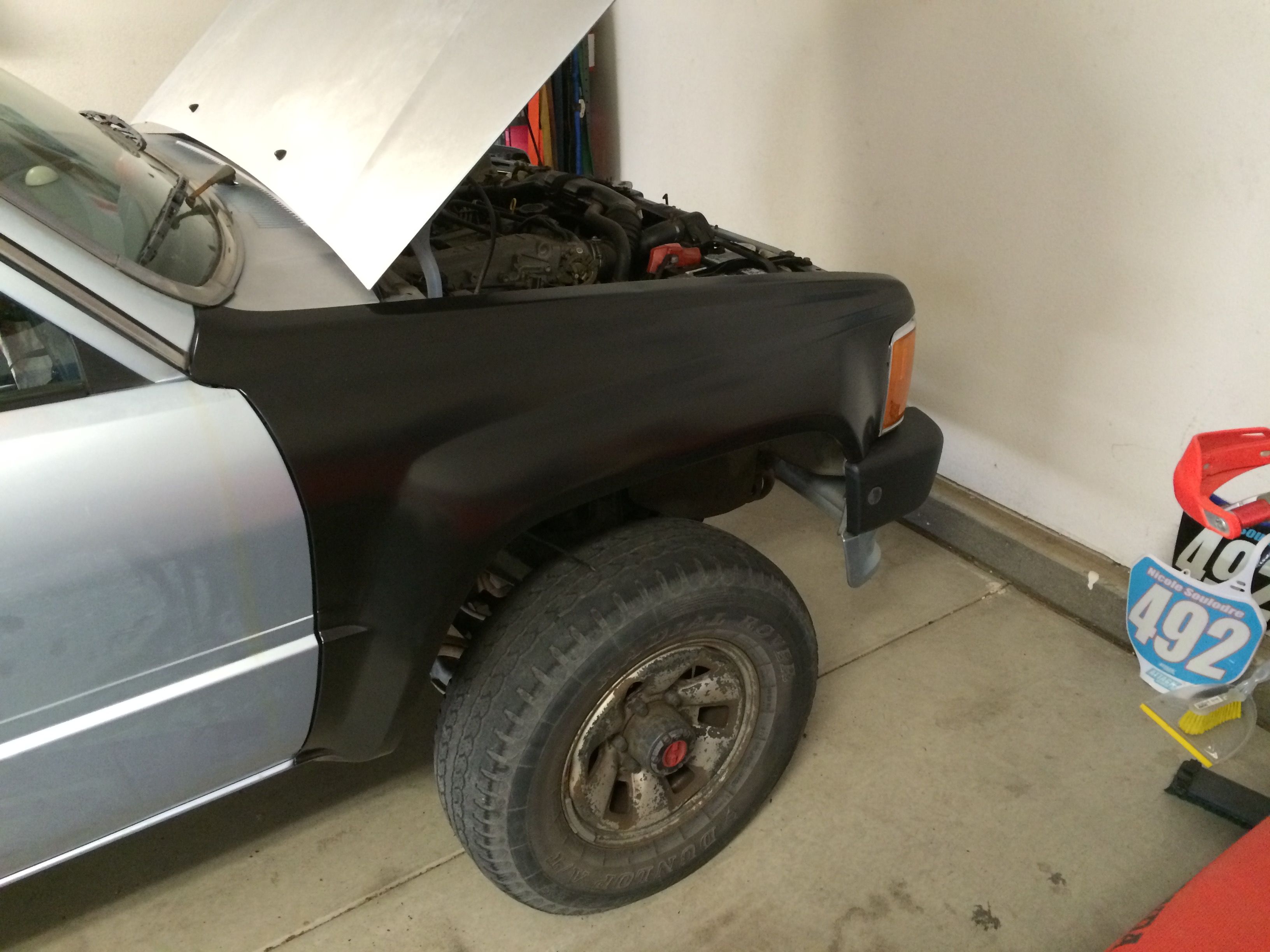

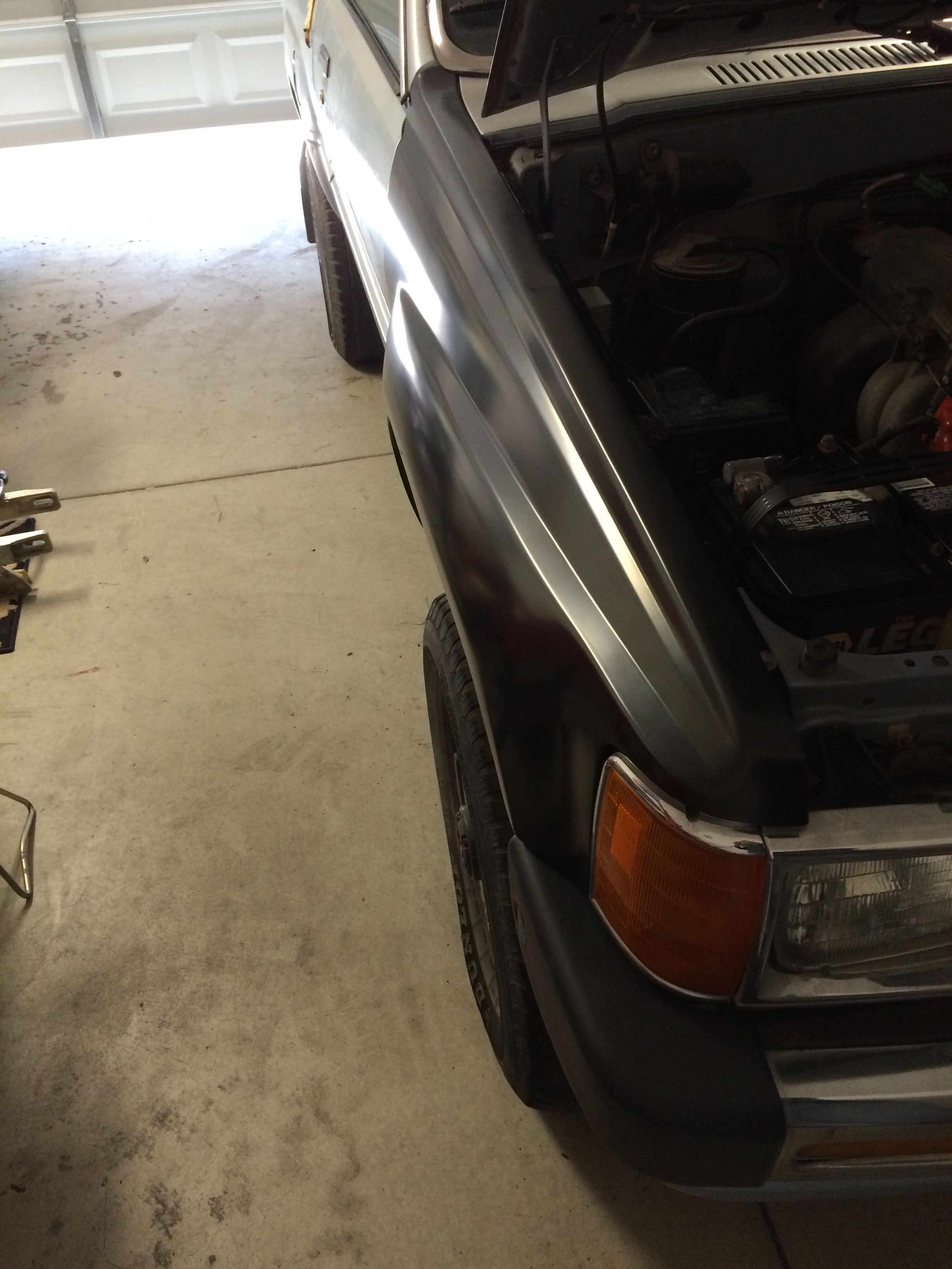

I got both front fenders from rockauto. the shipping is a lot compared to the cost of the part, but overall cheap when you think about it.
a couple of prepaint pictures:

Originally Posted by MMA_Alex
after painting the truck myself:
Your 4Runner looks great. Nice paint color!
I got a fender for my 1st gen off of eBay with shipping included it was a couple of dollars cheaper than RockAuto at the time. If you are replacing a right fender there will not be a hole for the antenna. I'm going to get a hidden antenna when I replace the radio.

From: Downeast, ME
the one i got from rockauto had an antenna hole. Im not planning on putting a stereo in this thing so I patched it. you can see the epoxy i used in one of the before pocs
