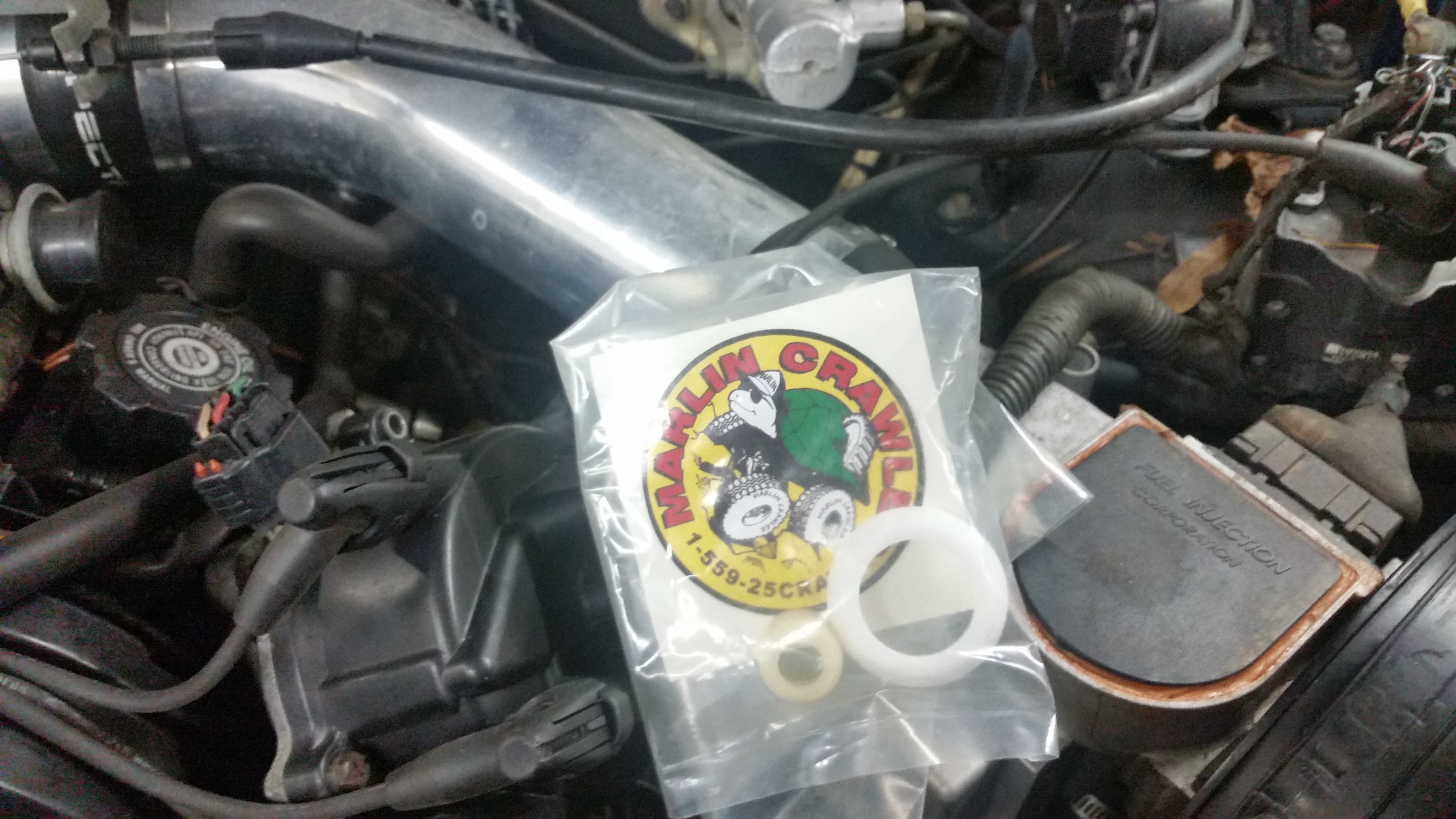

would seem I at least have the right stuff, for a change
Is that intake tube stainless? Is that a complete kit you got through Fuel Injection, Corp to included the hose couplers, steel tube, and AFM?
ha ha, nope. My tube split one day and I couldn't find a new one anywhere. Toyota wanted some ridiculous amount for it and 2 weeks to get it. I ended up at a local auto parts store and they had a turbo tube that looked like i could make it work. It was cheap too. Got it home and it fit like I'd designed it for it. I was a happy camper that day.
Ah, thanks! I'll have to keep my eyes open for something like that, then. The piece of electrical grade pvc I used to replace the stock tube is now beginning to distort after many years of service and I fear it could be a source of vacuum leakage....even though after numerous sprays with ether no symptoms have surfaced. Still, I just don't feel good about it when I look at it...haha. Makes it a pain to check the dipsticks, too.
