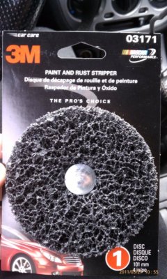

i have been prepping mine for about 3 weeks ago now. started with a palm sander but then found this stuff that works magic when taking off existing paint
i am shooting for a matte, satin, flat finish...do you think the roll on paint is good for that as well or only for shiny finish?
