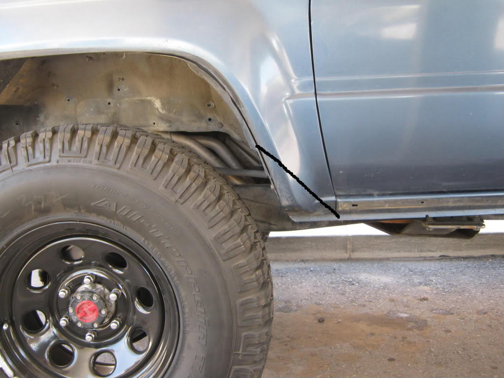

Pics.
Front.

For the record I'm not really happy, or comfortable, cutting on this rig. It's pretty damn clean and I wanted to keep it that way but I wanted the bigger tires and wheels and am paying for that now. I could have saved all this by just buying another set of 31's but then it probably wouldn't look like, or wheel like, I want it to. Or so I hope.

That rear cut is gonna be dicey. I never had a problem with my 35's rubbing right there. mine rubbed on top from when i had cut my bump stops with 31's How much clearance do you have in the back? Maybe relocate your axle back an Inch and it won't rub and then it's not a permanent modification to a very hard to replace body section.
I don't have that much flex due to the addition of coils (Zuk mod). Relocating the axle at this point isn't really an option since I don't have a place to do the work. I can cut in small pieces and flex it until it clears though. I've got a friend with a fork lift and we can use it to check clearance by flexing the rear on level ground.

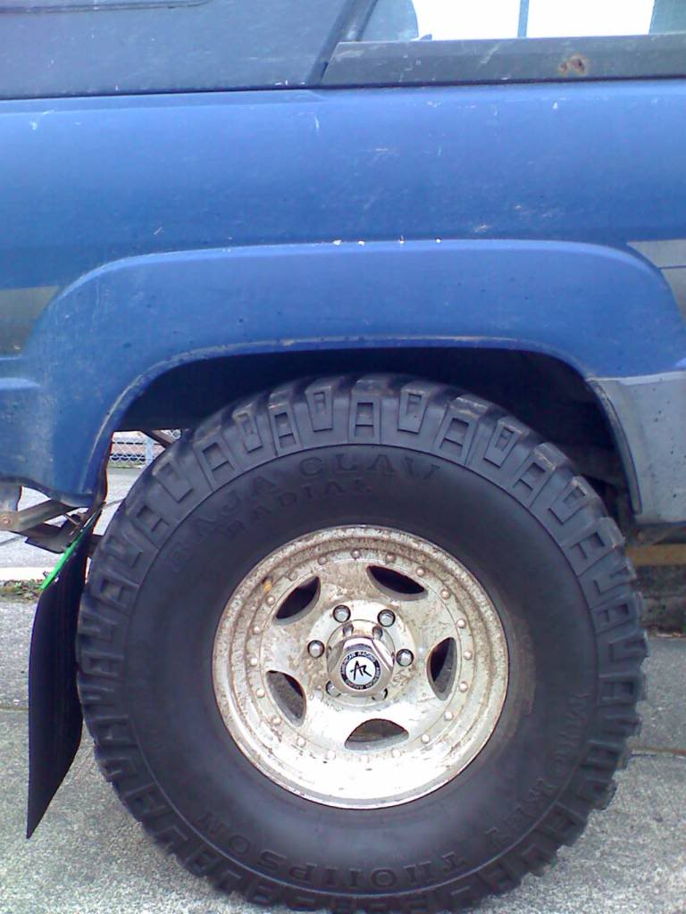

Whattya got 33's? I know I got 4" on ya but I've never cut squat of my rig. I can stuff those 35's just fine.....

Logan it's the new 285's and the rears look like they are going to munch fender when I stuff them. Should find out this week.

Got some cutting done and you really can't tell from the side that anything has been cut (which makes me pretty damn happy) I did a little flexing and there is one spot on the front that still rubs but I'm going to need another set of eyes to find it. As far as the rear goes I re-beat the welds a little and flexed it and the axle seems to move up and towards the rear a little as it compresses. So far I'm clearing the front of the rear fender by about 1/4". If it does end up hitting when I wheel it then I'll relocate the axle back an inch and see if that does the trick.
