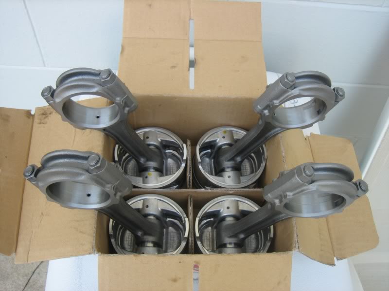

you know you have to have the new bushings honed to fit the pins right?
I pressed my bushings into the rods myself, and then took the rods and wrist pins to the machine shop that did my block to have them machined
pressed in myself:
and had to have the bushings honed to get the pins threw (same rods, just glass-bead'ed clean )

Originally Posted by 9o7yota
not using new pins...still need to get them machined?
yep
even with the old pins, the new wrist pin bushings need to be machined to fit the old pins
it's a little easier when you're replacing the pins too, cause you can bring all of the rods and bushings to the machinist, and just one wrist pin, and he can do them all based off of that one pin, since they're all new and will be the same size and specs
but using the old pins, you need to bring EACH pin to the shop with the rods so that the machinist can hone each individual one to fit, and then BE SPECIFICALLY SURE NOT TO MIX AND MATCH THEM UP AFTER THE FACT
I just assumed pay the $50 or whataver it was from engnbldr for a whole new set of OEM style pistons that came with new pins and lock retainers, and all was good
