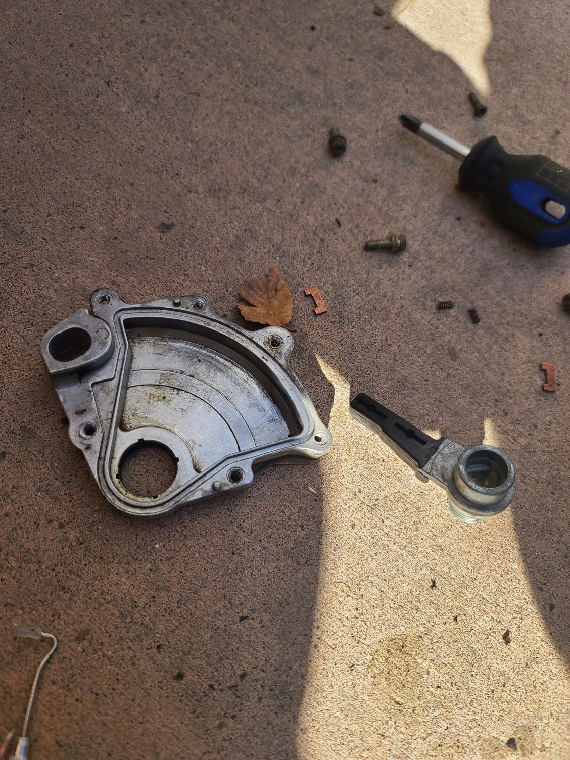

Pics of neutral safety switch both duty and clean...
The grease inside had turned into a weird colloidal plasticy stuff. The wafers on the arm didn't spring anymore. It was a mess!
I have backup lights again!
