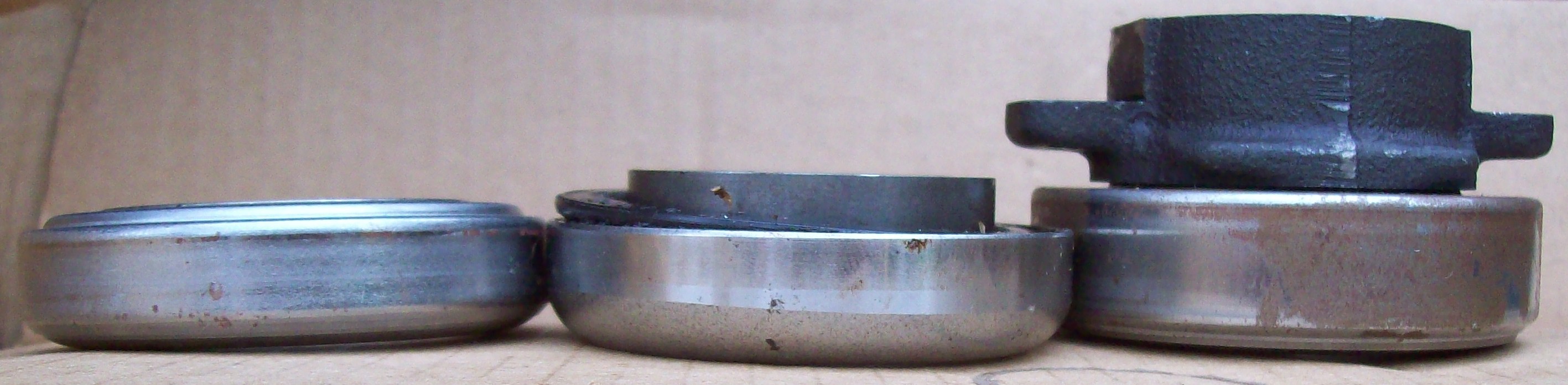

I managed to put the separated races of the old bearing back together with a BFH, so now I can clearly compare them all.
The old bearing had a bit of a sleeve extending below the inner race, so it sits at the same height on the bearing as the larger, thicker, new bearing. The other smaller, new bearing doesn't have that sort of sleeve, so it would sit lower on the hub, which leads me to think that the larger bearing is the best match.
Left: new, smaller bearing
Middle: old bearing (with dust cap half sticking out)
Right: new, larger bearing fully seating on old hub

that is interesting... as i recall, my throwout bearing was secured to the arm that went into the bellhousing with spring clips(???), and i don't see that capability with the two bearings on the left... is there a piece missing?
also compare the arms on the old vs. new pressure plates, that the throwout bearing rides on.
Old Jul 15, 2016 | 01:54 PM
ShadowTek's Avatar
Joined: Nov 2013
Posts: 50
The bearing gets pressed onto the hub, and the bearing on the right is already pressed onto the hub.
There are little clips that retain the hub to the clutch fork.
The new pressure plate looks the same, just that the dowel holes are a hair too small to fit over the dowels, but everything lines up and is dimensionally the same.

there aren't any arms on your old throwout bearing, to fasten the clips to.
Old Jul 15, 2016 | 06:03 PM
ShadowTek's Avatar
Joined: Nov 2013
Posts: 50
The hub is what has the arms on it. The old hub that I'm reusing is pictured on the right as currently installed on one of the new bearings. It was previously installed on the old bearing, the one in the middle of the photo.
