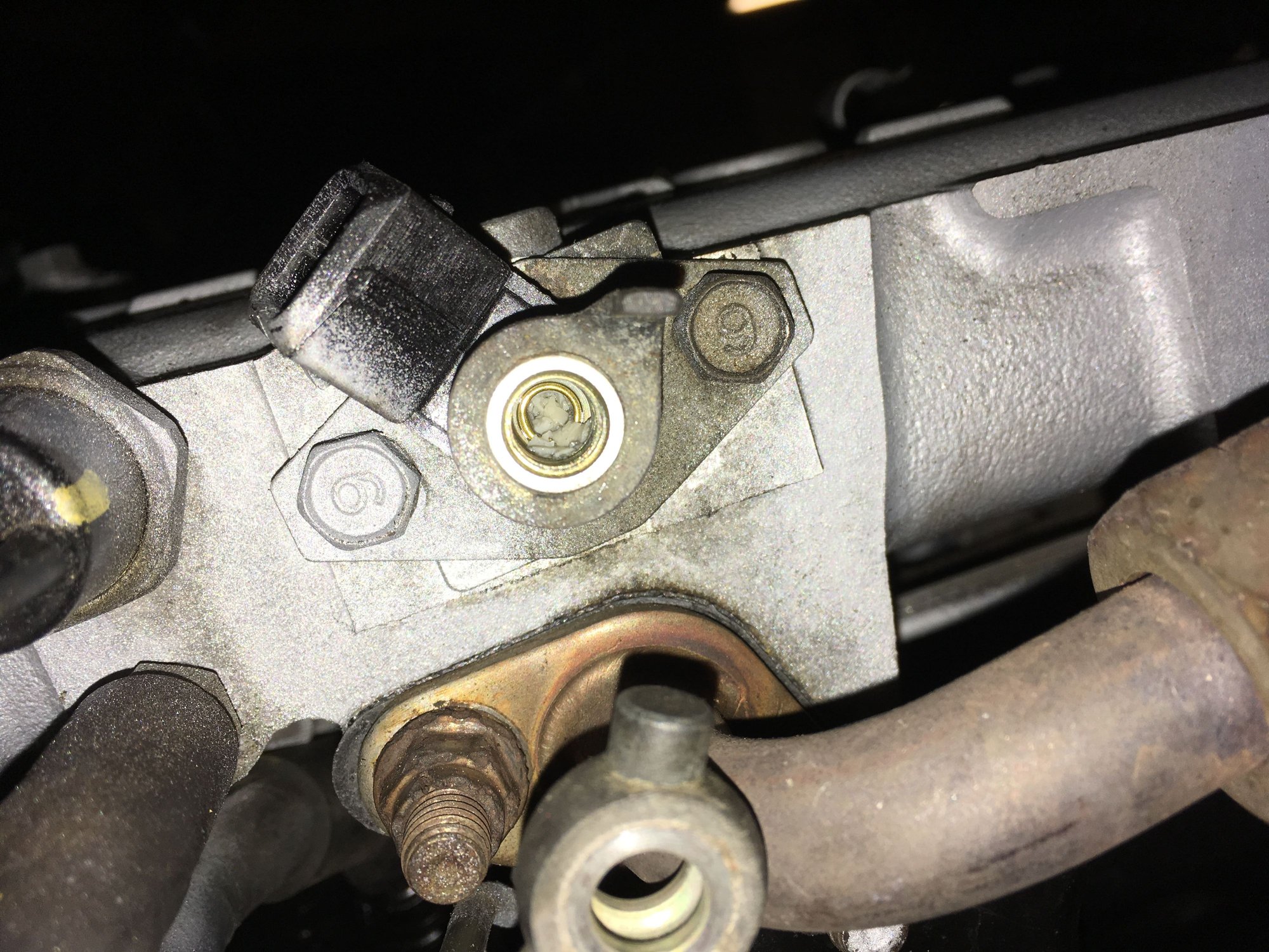

Does anyone know what this white garbage in my coldstart injector may be?

That white stuff is the gunk you get over time from moisture ECT (too lazy today to go dig out the chemistry info..). It's the root of your problem. Purge your lines, maybe change your pump sock and pump and clean your tank, and then change the filter.
You didn't properly test that fuel pressure regulator, goosing the throttle doesn't give full results just that it is appears to be sort of working. It could have been due to the voltage spike..
You haven't done the pump supply volume checks, it needs to flow in excess of the injector capabilities (injector size times injector count)..

By purge the lines do you mean replace, clean, or just empty? And any advice on cleaning this coldstart injector? or is it toast?

I think that gunk is your issue. If it isn't, it's still going to get your new injectors. Others may have a tried and true method but on my diesel machines, I try to find a connection in the fuel lines somewhere in the middle of the machine, and blow compressed air and maybe a solvent through them in both directions. Your fuel filter joint would be where to to this.
As to why it's shutting down completely, is suspect that your pump sock is getting covered up momentarily and giving you an intermittent loss of fuel flow. A clogged fuel filter fits the bill for why it might hesitate and then recover. One thing is for sure, you are going to have to get that fuel system cleaned out. If I were to want to clean out my system, I would blow it out, change the fuel filter, and then install a cheap, clear sided, inline fuel filter between the pressure regulator and the return line and then jump FP and B+ to let the fuel circulate. It will allow you to see what is purging from your rails and hopefully the main fuel filter will catch what is coming from the tank. I guess you could clean the rails up good before you put the injectors in them. I think I would also take a look at the pump, pickup sock and peek down into the tank and see what's in there.
Try cleaning your CSI. It is either working now or you don't need it to start your engine. It's easy enough to replace later if it fails.

I'll blast the csi with brakekleen and see if that helps it out. Noted on the fuel lines, ill blast compressed air through them while changing the filter. Its not shutting down completely it just stumbles, so fuel filter, which is on my laundry list.
