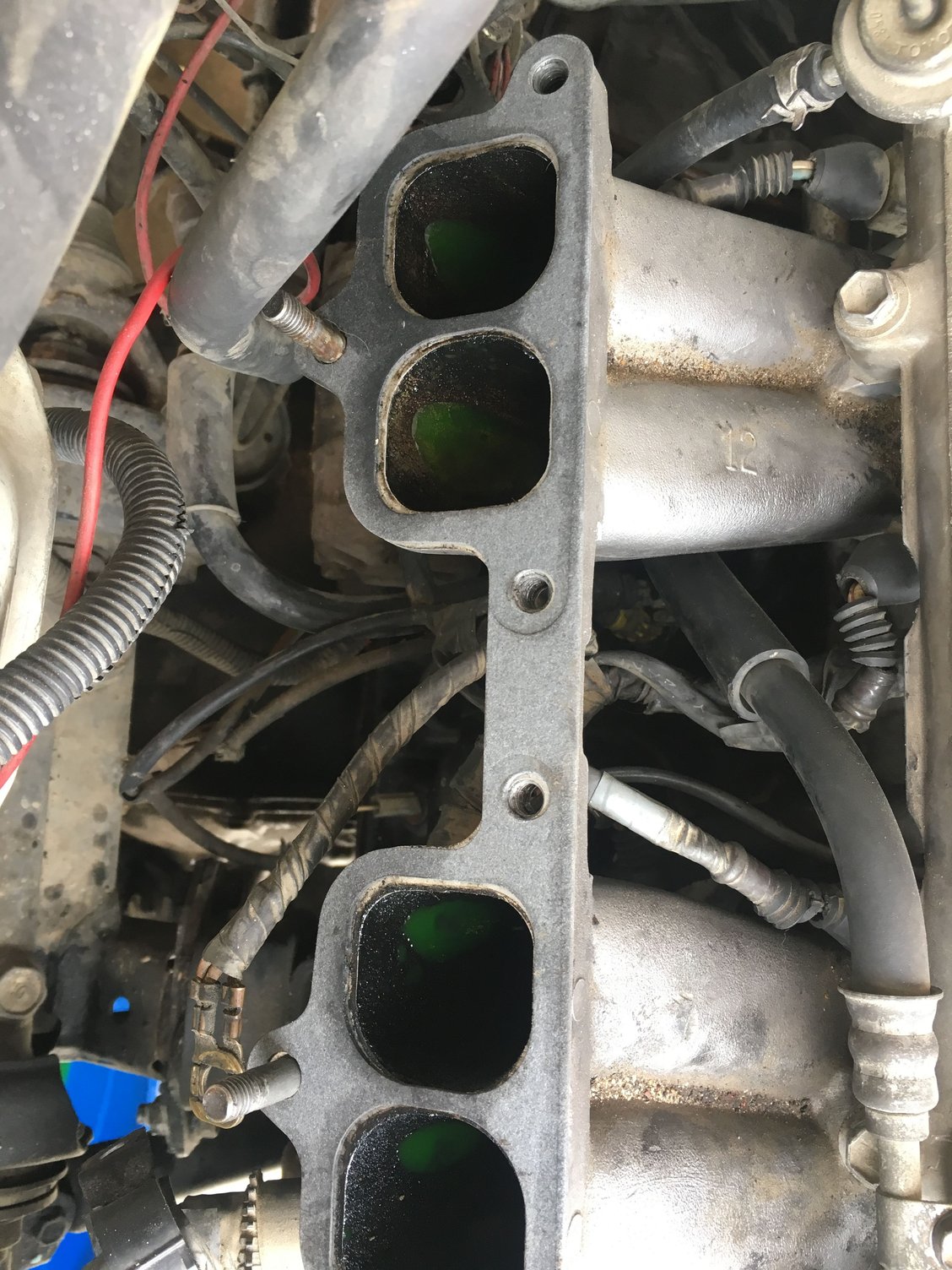

Im sure this question has been asked a million times but here it goes again. Recently rebuild 22re (hg, pistons, rings etc) runs ok but is just dumping coolant. Don’t know if I forgot to hook something up or a bolt somewhere or what. Not too much experience with 22res. Started up, ran fine so I put some coolant in it. After that, just started blowing white smoke. Pulled 123 plugs and they were all ok. Dry. Pulled number 4 and it was just soaked. Started tearing it down and there was moisture on the intake side of the tb. Plenum has coolant in it and manifold has puddles in it. I did cheap out on the hg so could it be that? Or did I just forget to hook something up right?

That picture doesn't really help us tell if anything is hooked up wrong, which is what I'm leaning towards. Pan back a bit and give us a good view of how everything was hooked up.

Everything’s kind of disconnected now lol but heres a little further out. Anything in paticular?

Often in your case what happened is that one of the larger vacuum hoses was accidentally swapped with a coolant hose. Check the path of everything that was plugged into the intake plenum. There's the i.a.c.v. that has both air and coolant hoses which could easily be mixed up.

Looking at your photo again, i'd suspect that coolant hose you currently have wrapped under the thermostat housing. Where did you have it routed?

That definitely makes it difficult to tell, I'd take GSP's advice and hook everything back up, making sure that coolant lines are going to coolant ports. I'd also suggest adding your vehicle info into your signature, and adding your location. There might be someone in your town that could come look at it.
Had it routed to under the throttle body right under the tps. Saw it was a coolant line and saw the corrosion on the nipple under the tb and figure they were a perfect match 😂
