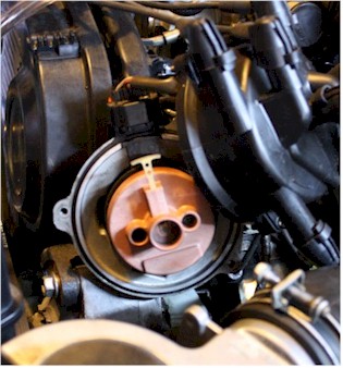

turned crank to TDC and took off the distributor cap. Pic shows the position of the distributor rotor.
Just for fun I moved it one tooth to the right and one tooth to the left to see if that help it run.
One tooth to the right and she wouldn't start.
One tooth to the left and she ran at 2000rpm and about 30 degrees BTDC.
I'm pulling the timing belt cover to double check the belt timing.
Stay tuned.
Badbob

Ok, just checked the timing belt and it is lined up perfectly.
Crank is TDC
Cams both line up on the white marks.
Humm . . . so why is the timing advanced?
And why is the rpm running 2000rpm at idle.
Please post suggests and ideas
Thanks Badbob
