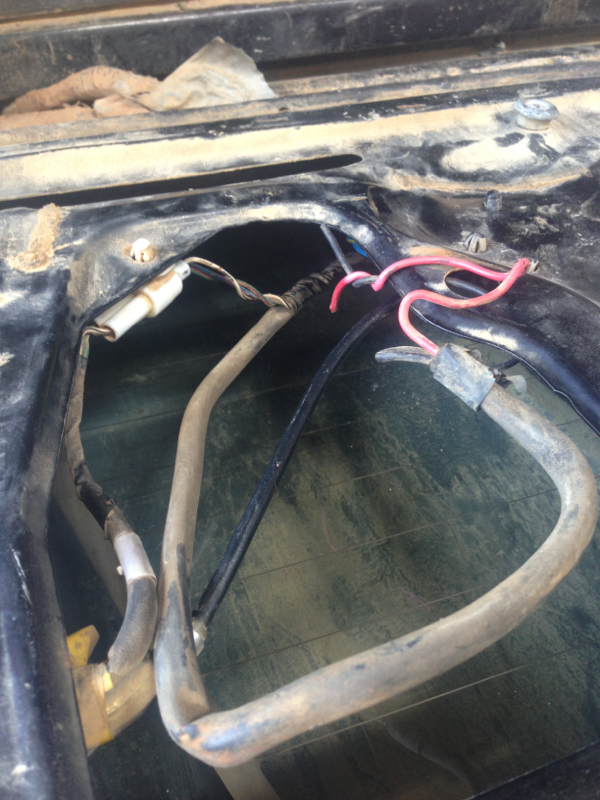

Ok, I replaced all four relays and they r working but not rolling window or wiper working. I'm missing something somewhere. There is a black wire and red wire in the tail fate that is cut but it looks like its been that way for a long time. Any idea? And what this might go to? I don't see any where it was connected.

It is looks like it should go to the latch safety thing.

This what it looks like.

I believe that goes to the defroster. If you look at the bottom corner of the window (in the 1st Gen it's the bottom driver's side) you'll see two flat prongs. One pointing toward the left and the other point forward (if memory serves me).
