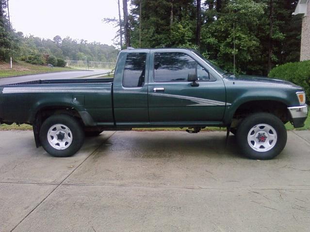

photobucket wasnt being very nice, but here are some attachments of it
i told ya shes ugly... right now atleast, hopefully tires and rims will fix this

Wow a 94 with a 22re is a really good find. To be honest, once you throw some 31's on that thing you probably won't even notice the sag. But i would go with the shackles to keep your ride soft. Although i put rear add a leafs on my old 86 4runner and they really didn't make the ride that rough, $50 from suspension connection.
