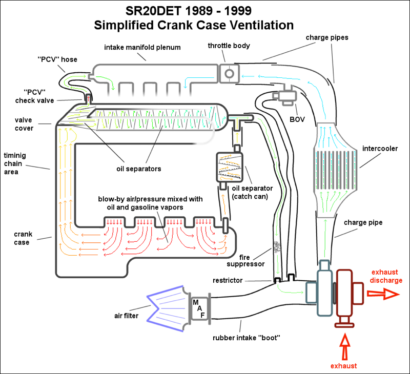

From the interwebs:
Attached Thumbnails Rear mount turbo 3vze finished-image-3599898823.jpg   Rear mount turbo 3vze finished-image-350285334.jpg
