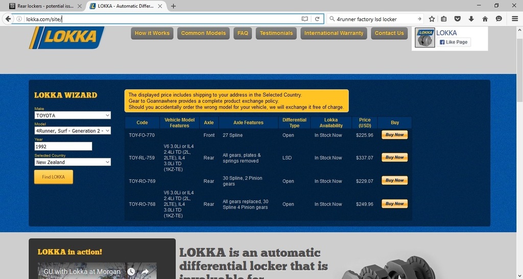

heres a pic of the lokka 'wizard' (US website) application listing, the wizard on the website would not come up with its own link...so i took a screenshot (strange how it lists V6 3.0Li...did they make a 3L v6 injected diesel?)

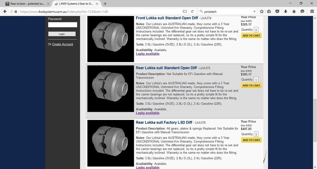

heres a link to the 4wd systems lokka for ur reference, also found part number LKA376 (and this listing specifically says not for use with manual 3vze's) u can narrow the search field to 130 series 4 runner, and the diff will not be listed
https://www.4wdsystems.com.au/index.php?id=125&cat=148

The only thing I hadn't clarified on my own was what's shown in that last pic. Which clarifies nothing actually. Why the same pic of a 2-pinion locker for all of them? That's not very helpful or informative. And I guess clarify is the wrong word for the aussie connection. As I'd only speculated that much. They're know as an "aussie locker" in these parts.
I meant 4-pinion non-LSD. Which has enough in common with a 4-pinion LSD that it kinda surprises me that they wouldn't use the same locker(it's 4-pinion so what else matters?). But then again it doesn't surprise me. Because the side gears, and maybe the pinions too, would likely be different. I would, however, think that the carrier itself would be the same(or close to it). I know they look exactly the same from the outside. And without close inspection it's hard to tell them apart. Where's ZUK when we need him? He'd know exactly what the differences are between the 2. I've only seen pics of the 8" 4-pinion LSDs. He's worked on all of them.
