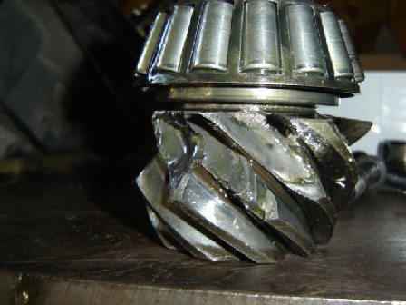

I didn't even know all this was going on. I had .033" of runout, assuming runout is the side to side movement of the carrier. I had .051" of backlash. Way out! This is my own fault. The carrier bolts were not tight enough from when I installed the locker. I didn't use any threadlocker. Won't happen again. Now I am at a sticking point because I don't know how I'm going to perss the bearings on and off. I might have to get into the savings a little and spring for a little harbor freight shop press. I'm hoping to find one to use somewhere though.
Whoa .051" is a tonne. What do you mean by carrier bolts? the 4 bearing cap bolts. If so I reassembled my diff yesterday, got interrupted, came back, installed the diff and tested it out. Only that night did I realize that the bearing cap bolts were just a little more than hand tight! I just about crapped myself. I pulled it all apart yesterday and luckily had no damage. Re-check backlash and carrier bearing preload. 0.008" and "high" respectively- as I left them. I'm going to button it all up today.
