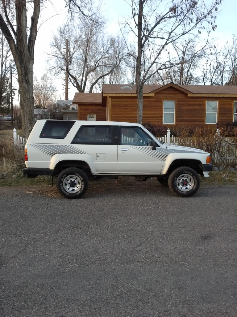

This is how the 4runner looks stock

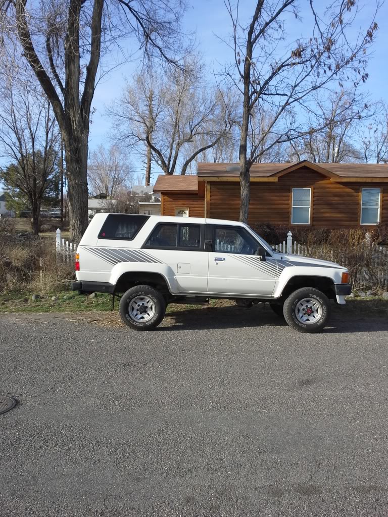

Here is the first height with the springs installed, way too high

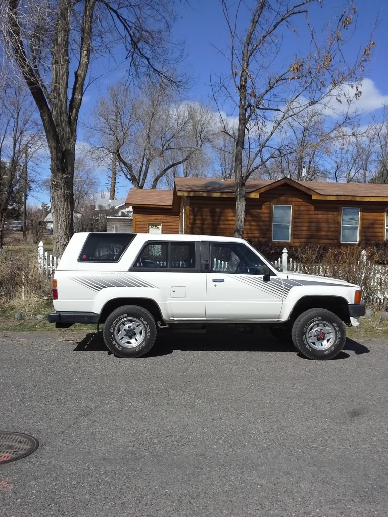

This is after the springs had been cut two coils

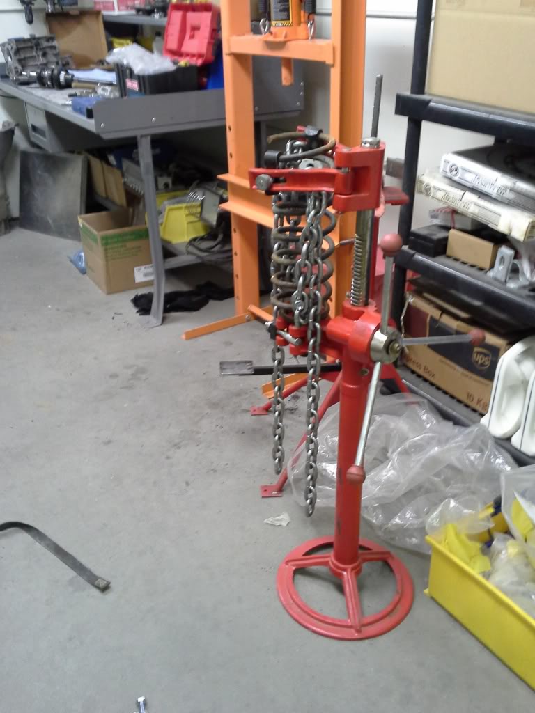

I wouldn't recommend compressing your springs this way but I had to get creative. No Schucks nearby. I was very careful and went extremely slow

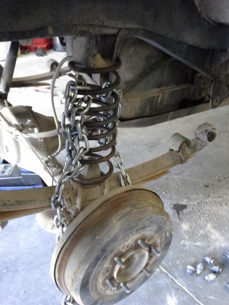

Here you can see what I did to drop the axle. I first removed my shocks from their bottom mount and then while supporting the axle removed the bolts at the front of the leaf springs. Be careful not to let your axle hang by the brake line

Overall height difference was 3.5 inches at the rear bumper.
