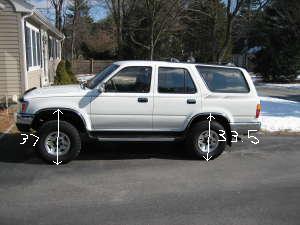

So i understand the fenders are cut unevenly i'm just wondering what you guys have for measurements from the ground to the top of the wheel well.
I have right now
Front 37"
Rear 33.5"
Attached Thumbnails Rear Coils Pro Comp vs. Moog vs. OME-copy-hjk50y5bufeirhwlxabtncn8pig4.jpg
Old May 25, 2007 | 10:43 AM
  #24
FredTJ's Avatar
Joined: Aug 2006
Posts: 1,518
From: Tucson, AZ USA Age:60
I have right now
Front 37"
Rear 33.5"
With 31" tires.
Front 37"
Rear 35"
Bottom of rocker to the ground:
Front (behind the front wheel) 21"
Rear (in front of the rear wheel) 21"
Fred

thanks for the help guys, i just ordered a set of moog varible rate springs. i'll let you all know how it works out.

Alright i got my MOOG spring and installed them. Everything thing went smooth except getting the rear wheels off.
It looks pretty level to me and the ride is much better. Taking it out for the first ride i realized that i used to bottom out on almost every bump.
Thanks for the help guys
