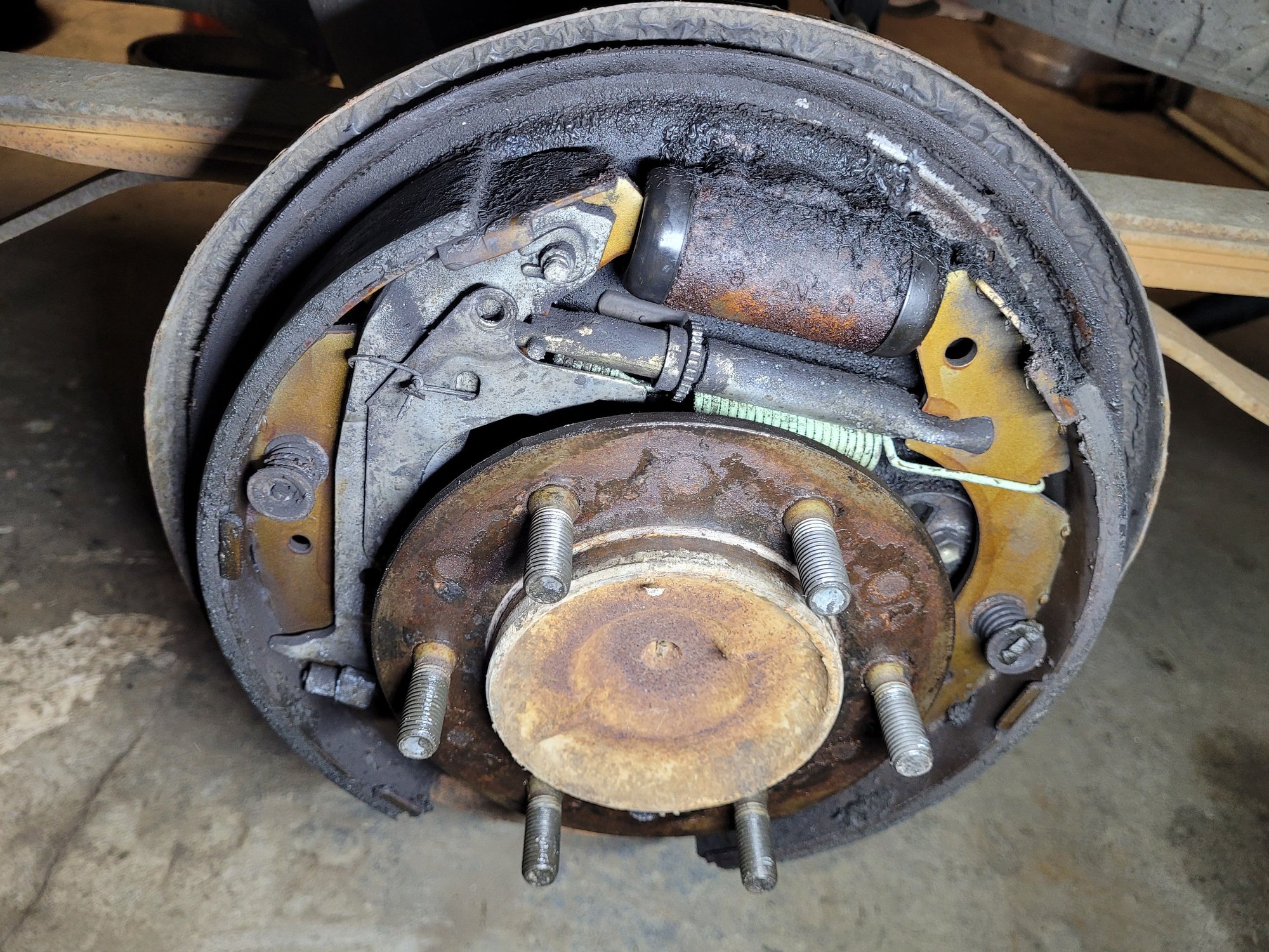

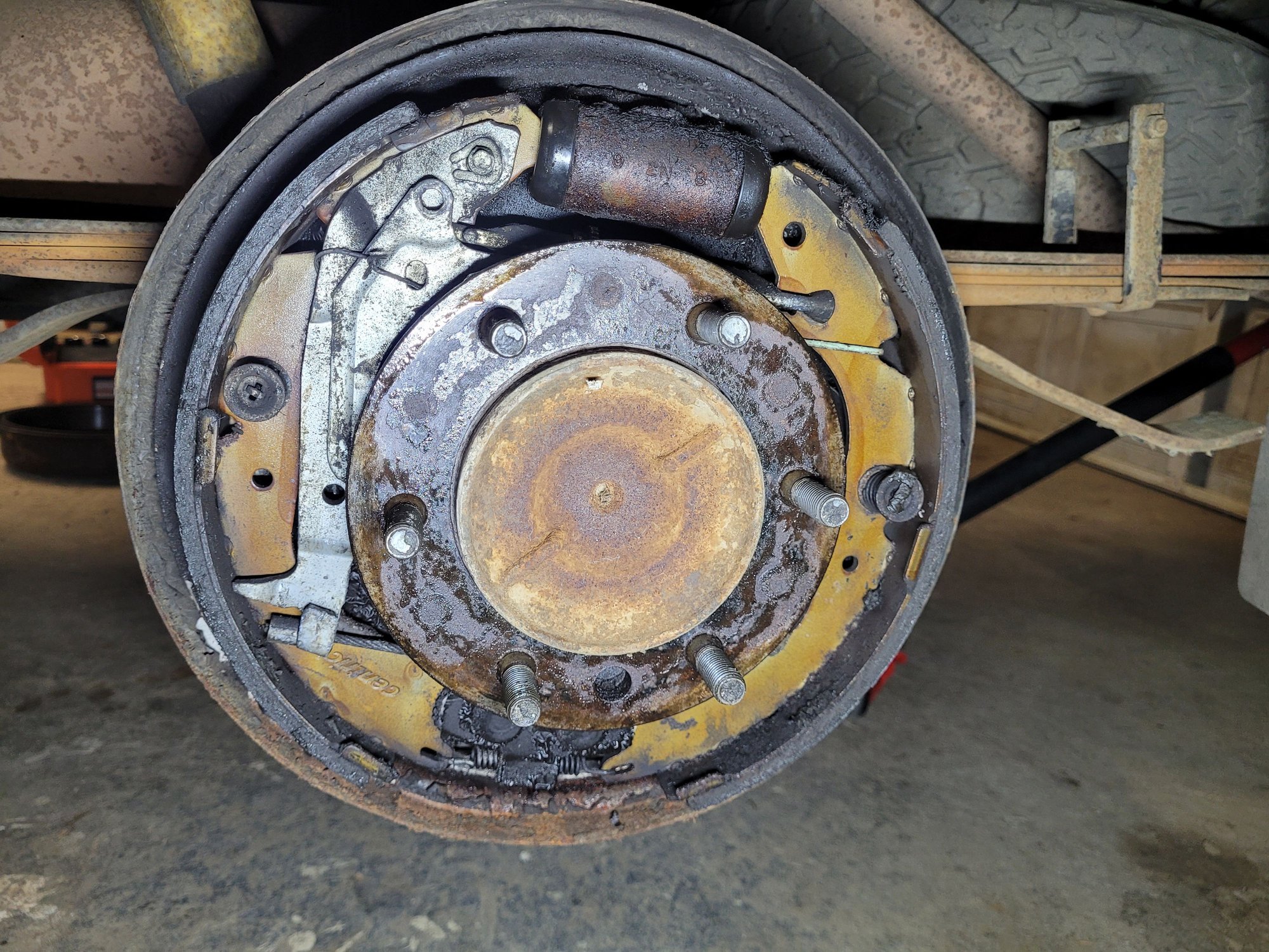

Rear brakes started locking up while driving around today in my 86 4runner. Made it home and found the passenger side dragging hard. The drivers side looked like a mess inside. PO disconnected the parking brake cables. Said it was because of the LSP & BV. I'm just starting to work on this truck. Any thoughts? Attached photos are of the driver side which wasn't really dragging.

Pretty sure that arm on the upper left side that has the twisted wire holding it in place is not correctly installed. The portion of it that reaches out to the right is supposed to make contact with the teeth on the adjuster wheel I'm pretty sure. And these brakes are supposed to be "self" adjusting when you activate the parking brake, so yeah clearly that mechanism has been disabled on purpose by the PO. The FSM might have a good image, but if not, hopefully you can find some good pics.

Ya no doubt. It's zip tied on the other side. I was more worried about all the grease and the fiber that's piled up on top. I'm pretty sure the load sensor is way out of whack but I'm not sure about the process of adjusting it. I've read it in the FSM but it seams like it may be beyond my tool sets. Grease from the axel seal?

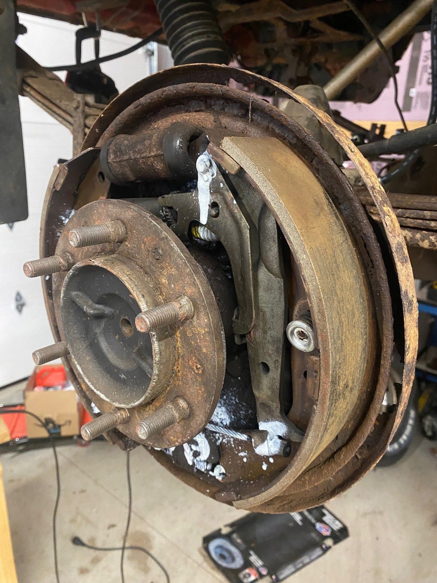

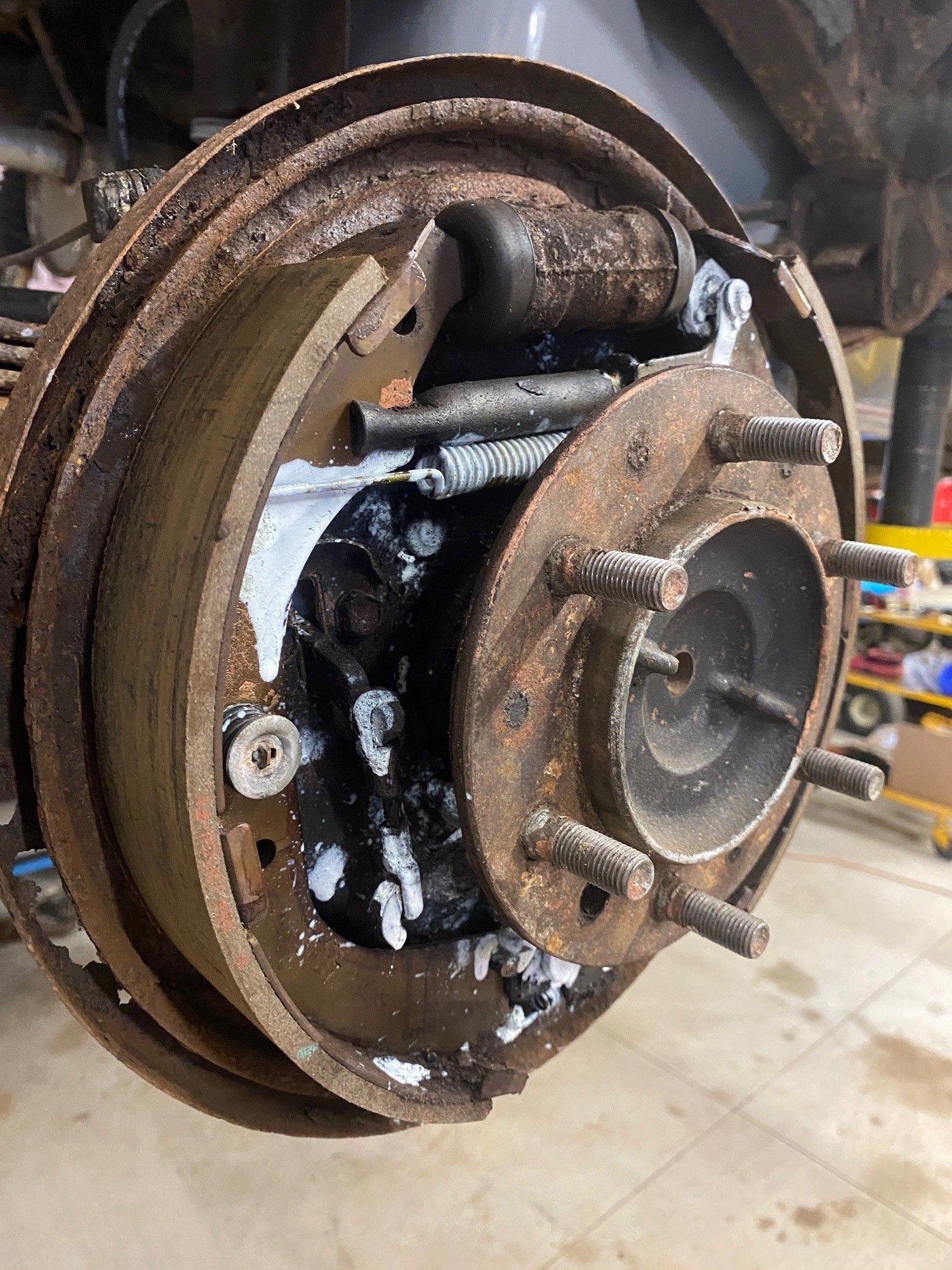

i don't have much input to offer as I'm still working on what began as my brake system and has snowballed into.... anyway, I would just clean it all out real good, connect what's supposed to be connected and go from there. Pics from when I was freeing my outer and inner bell cranks
Thanks hurricanes. Looks familiar! I'm wondering if it's possible that a combination of my really bumpy road and the fact that there are virtually no shocks in this thing made the rear end bounce up and down so much it caused the LSV to over pressurize? Basically thinking it was loaded and unloaded with each bump that it just over loaded the brake system. I'm going to do exactly what you said though and start putting it back together and see what's failing. I'm still feeling a little daunted by the FSMs explanation of how to test the LSV BP. Guess I'll cross that bridge when I get to it. The kicker of this whole thing is that I was on my way home from auto zone with parts to fix the suspension, brakes and exhaust so I could go get it smogged tomorrow. Guess that's on the back burner now. Haha!

I'd probably start with determining what the lead was before I clean. Like pull the lips of the cylinder back to check for moisture. But whether wheel seal or brake cylinder you need to fix that obv. Your shoes don''t look much warn either. Sadly I don't think you should try to clean those shoes. You really can't get fluids out of the friction surfaces.
Hurricanes Left rear has a good pic of the "self" adjust mech. That baling wire on yours is holding that part that should be on that pivot pin on top of rear-side shoe. Of course that mech wont work well if the park brake cable isn't functioning.
While you're at it ensure those cables move freely. I had to disassemble my driver side and put pbblaster down it and work it for a few days. Should I just spent bux to buy new?
Yeah. Probably.
The spring under/behind adjusting cam is a bug-a-boo. Takes patience and (I had to get help) 4 hands to reassemble. I'd get all that squared away before I started worrying about the diverter valve.
Also the actual shoes are the same across a wide range of years. My 95 shoes are exactly like a 99. (Altho the actuating and park brake assemblys are way different.)

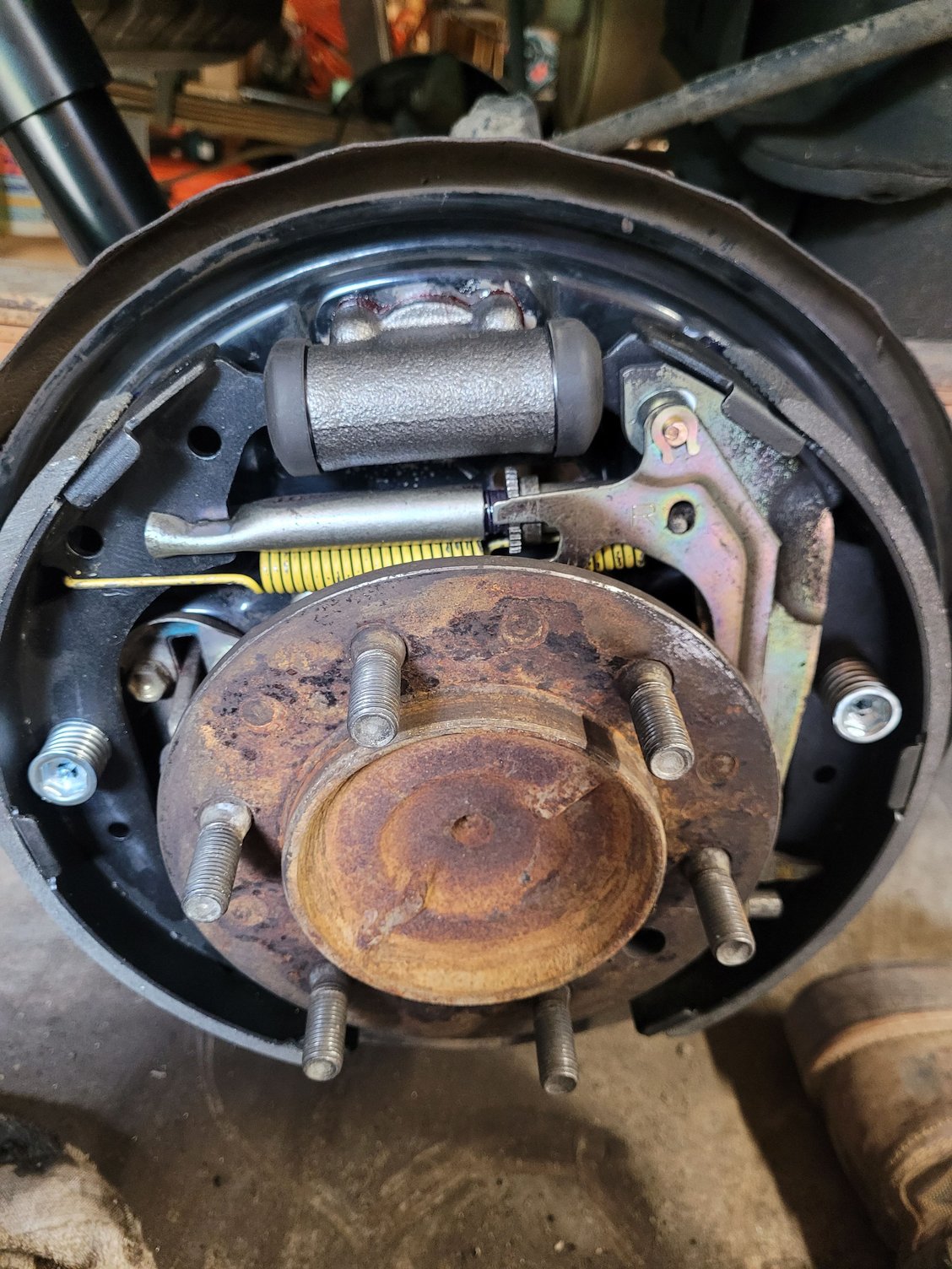

Well, I pulled the whole assembly apart today and cleaned everything. Opened the cylinder boot and a ton of brake fluid poured out. I went ahead and put a new cylinder in and will put everything back together in the morning. Also got new shoes to replace the damaged ones. I went ahead and ordered a cheapo aftermarket LSPV just to see if it fixes the issue. I also found a supplier out of England that carries the spring and boots for the whole assembly. As a side note, I replaced the shocks as well and lo and behold, the old one were completely dead! I'm hoping with the new parts and new shocks my rear break lock up issue will subside. Plus, it'll be nice to have ap parking brake again! More to come...

Looks a little better. Went ahead and redid the front brakes and calipers while I was at it. Also put in 4 new shocks, replaced transmission, transfer and diff oils and put in a new lspv. I even found i was missing 2 engine mount bolts. No big deal... I'll take it for a test drive in the morning. Fingers crossed! 🤞🏻

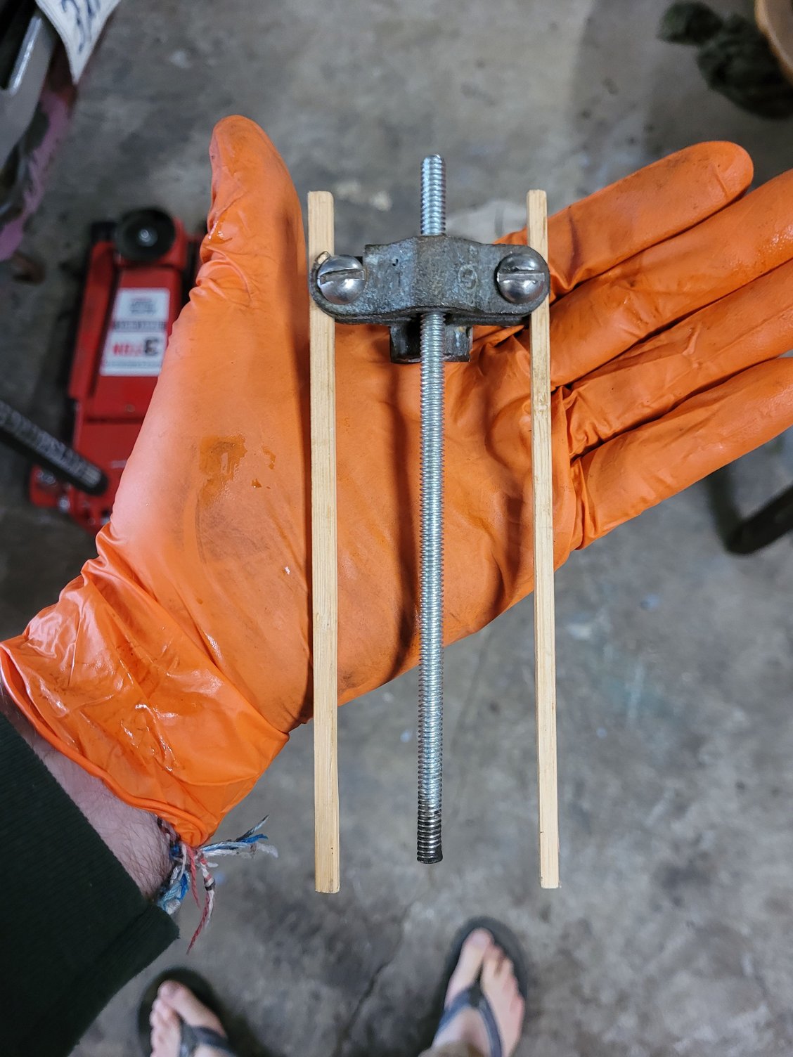

Push rod for the booster / Master cylinder was out of adjustment. I didn't have an adjustment tool so I cobbled one together from stuff I had laying around the shop.
Bench bleed on the master cylinder and now all's well in brake land once again. Too bad that led to an electrical rabbit hole that I'm now chasing. But at least I can stop!
