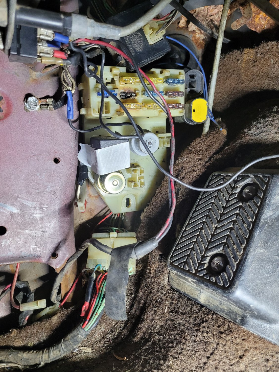

Thanks y'all for the suggestions. I'll start chasing things this week. Some things I know the PO did to butcher this harness include:
- Swapping from an automatic to a manual.
- Splicing in an aftermarket stereo.
- Wiring in a "kill switch" on the starter.
- Rewiring a switch for the rear window.
I've already pulled the stereo and will work on rewiring that. I'll post some pix of the rats nest I'm dealing with. I am especially stoked on the fuses that are oversized and/or burnt! 🙄

About what I figured.
They have stereo wiring kits available that will fix the loom at that location. It'll even have a connector like the oem. You can either source a oem stereo and just plug in, or get an aftermarket unit and an adapter wire that lets you plug the stereo into the loom.
I solder and shrink tubed my repairs, but working under the dash isn't fun, especially the driver's side. I do like the non-insulated crimp connectors. Then you can slide shrink tube over the connector. A lot cleaner(thinner) looking than those blue and red insulated ones typically used, and I think the shrink tubing minimizes wire flexing at the connection.

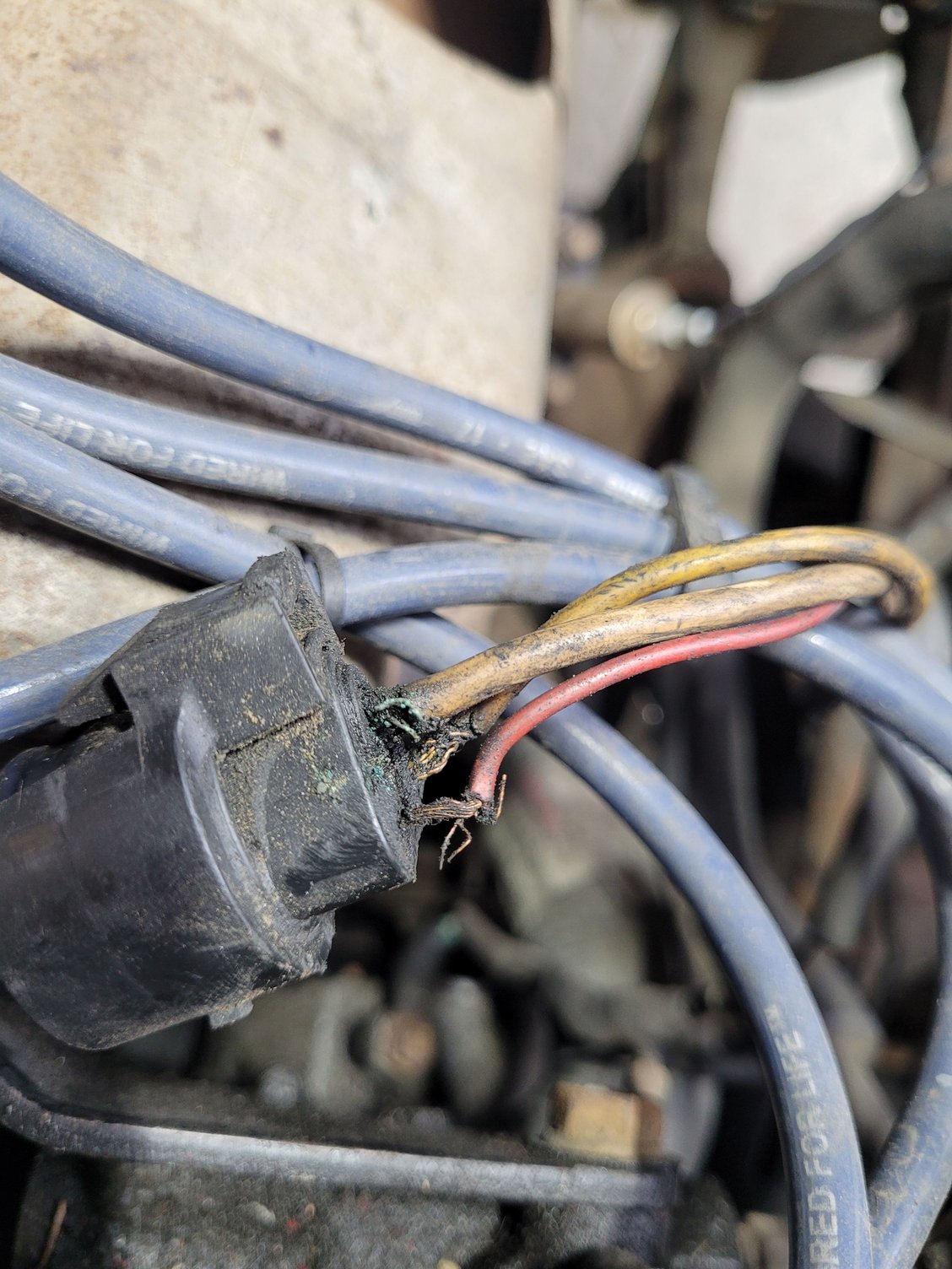

A big part of the mystery has been solved! While it doesn't account for all the ˟˟˟˟ery the PO did with the wiring, I found a big part of the mystery power draw. The 3 wires on the connector for the alternator were all worn bare, coated in power steering fluid and oil and subsequently all touching each other.
I only found it because as I was disconnecting and reconnecting the negative cable from the battery I heard a popping/ sizzling sound, look over and see smoke then a little flame! Glad I sorted that out before I came out to find a flaming inferno! I'll keep working on replacing and repairing all the wiring but thank you to all who offered suggestions and pointed me in the right direction! I feel a LOT better now...

I found a video on YouTube that explains very similarly the problem I had. Mine was the connection though and not the diode itself.
