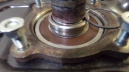

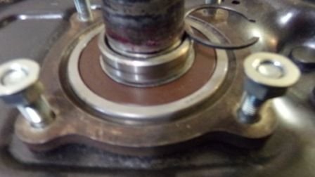

rear bearing photo
Heres some reasonable pics I hope.
Bearing set into housing; where it should be
Housing slid down

An update if anyone ever sees this.
So I had noted that I had some markings on the inside of the hub. Both of them actually. Like heat damage, bluing and discolor. I took some 240 emory cloth and cleaned it up a bit.
Realize that doing this will take some amount of material off the hub.
Quite a number of shops had suggested taking a punch and peening that inside surface to create friction points. In fact there were some punch marks on the outer edge of one of the hubs.
So maybe the side that had been replaced prior had the issue?
I had gotten an idea from some machinist websites, so I found some Loktite 660. Its a pretty thick grayish (almost looks like it has metal particles in it?) gel.
I put some around the 'outside facing' edge of the outer race of the bearing. Actually both of them becuz I took the other side apart again. And on the one side that fell out just placed it back in there.
Theory is that the thin ring of paste would push towards the 'inside'. It did not ooze out of the inside part of bearings. meaning the inside face of outer race.
I left it set for a weekish as I went back to NM. Came back and I have no play at all. Will it be a royal pain if I ever have to replace the bearing again? Most probably.
Seems pretty good to me. But what do I know.
Oh, as a side note. I probably had NOT need to worry about the 'play' I thought. As I noticed the gap between the bearings inside 'cover' would be taken up by the space of the lip or edge on the axle that surrounds the inner seal. So perhaps the only thing I might have prevented is the outer race spinning inside the hub housing. I don't think that would be good under any circumstance.
I'll let you all know if it falls off. Assuming I ever get it all back to gether.
