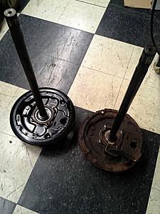

Times infinity. Rock Auto has a good selection of quality replacement bearings and seals for reasonable coin.
New vs. old.
Attached Thumbnails Question on Reusing Rear Axle Bearings That Have Been Pressed Out-20160527_222123.jpg
New vs. old.
Sometimes used is not too bad. Take these backing plates that I sourced from Montana for $35 bucks apiece. With with the bearing case and the parking brake lever included!
