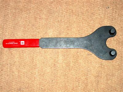

Lastly, I could not have done it without one tool I purchased (photo)- the Cam tool that also aided in the crank. I could have broken my new cam tool by using it on the crank, but I never got around to making a crank tool. This tool did hold the crank to torque it to 181 ft lb - again better than it was when I loosened it.

Awesome, Starr! Dive right in there--it's not a hard job. I always take off the cam pulleys to replace the seals but you don't have to remove them otherwise. Getting the crank bolt loosened and tightened is the hardest part but making this tool makes it much easier. It can be used to hold the cam pulleys while removing or reinstalling the bolts too.
