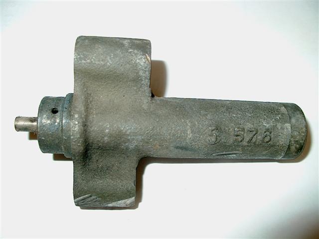

Not sure how I made it home. Check out this - lost one bolt and the other is broke off. Heard this piece rattling on my belts.
I drove about 100 miles after this broke off. I am sure the timing belt was going to fail real soon.

Can anyone explain how I was able to drive for 100+ miles. Is this just a tensioner on the timing belt or is this a spring to hold the tensioner pulley in place at the proper tension? I wonder what the inside looks like, it appears that there is a seal that should be on this and a pin according to pictures on the 5VZE on Pirana's timing package on eBay. But I have a 3VZE?

thats your belt tensioner, you might have dodged a bullet. youll definately want to tear into the front end of your motor and check for damage. do the water pump, t-stat, all belts, idler pulley and inlet pulley while you have everything apart.
youll also want to verify that your cams and pistons are 'in time' as that tensioner may have let things jump a little bit. there is a platic cover for the end where the little pin is, you may want to scour some auto recylcers and see if you can get a complete ass'y.

You are probably alright. That keeps the tension on the idler pulley, but I don't think it's loose enough without it to actually jump time unless you were really giving it a workout. It may have allowed the idler pulley to rub against the plastic cover, though.
I agree with leebee; you dodged a bullet!

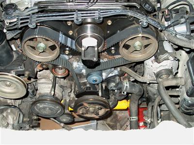

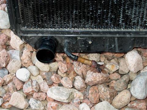

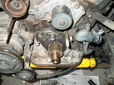

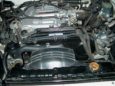

It is going much better than expected - I have not even asked my father-in-law mechanic for help yet. So Here goes the photos and the advise for others that will follow me. I dont have the parts yet, but really wanted to get going on it, expecting the worse.
Pic #1 - the START
Pic #2 - Be Careful, the coolant and the oil lines are really close - I will not be using my coolant over as it is now ruined (and I have done this part before- darn)
Pic #3 - Expecting damage, but all looks good so far.

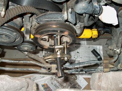

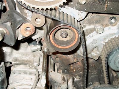

The timing belt looks good for not having a Tensioner on it. Wondering now if I needed to do all this work - but in the end I will be happy.

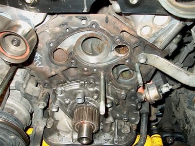

More pics:
Pic #1 - The Tensioner Pulley #1. Here is where I thought there would be damage of some kind - but it looks good and spins good. It is going to be replaced anyway.
Pic #2 - I read every Timing Belt thread there is on here, because I was so worried about that 181 Ft lb Crank Bolt - well - it came off, guessing it was about 80 ft lbs, not 180. I used a CAM Shaft tool ($30) to hold it just to see totally not expecting anything to happen and wala - off it came. Then the Pulley itself would not budge. The Tool you see is a loaner from the local Auto parts store - If it looks crooked - its because it is - but it worked great.
Pic #3 - The Timing Belt is Free. Now I am looking at that water pump and it looks fine, but since I am in here, off it comes, but I think I will wait until the new one arrives in the mail.

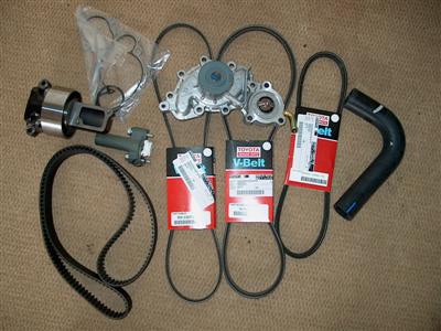

Its Time to put it all back together - the parts are in. Thanks Toyotapartsales.com - great pricing. It is a little more than ebay or parts dino, but I have Toyota parts and that makes me more comfortable.

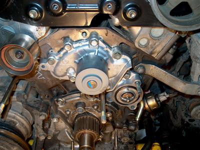

First change is the H20 Pump. Mine looked fine, but who wants to come back in here anytime soon. Its really amazing that the Dealership wanted $300 to replace this once they are into the Timing Belt change - the part is $84 and comes with the FIPG already in place. For those who are needing to replace the water pump - it was a piece of cake once your this far - the hardest part was getting the old seal off. A little scraping and cleaning and its ready to go.

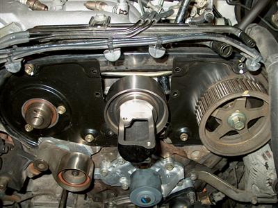

Getting Close - Timing Belt is on and lined up!
The new water pump is on with no problems, the new #2 Upper Idler is on with only minor problems - Toyota did not want you working on this without removing that brass line (I don't know what it is, but I am not removing it) so out come all the flex extensions. The belt is on and all lined up, but I am waiting on one last part to come in the mail - the #1 Idler pulley.
Caution - do not test the timing (as I did) without the tensioner on the belt - per the FSM - due to the lack of tension, the belt sliped one tooth, so I had the pleasure of doing it all again. The way it sits now appears correct - I will test it once I put on the new #1 pulley and the tensioner. Questions anyone? Now I really wonder how I drove over 100 miles without the tensioner on the #1 pulley if it slips with me turning it with a wrench?

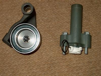

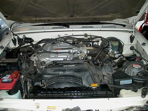

Last part arrived in the mail and on it went - the part that started this whole project: the TENSIONER and the Tensioner Pulley - or Idler Pulley #1. And a photo for the engine back together and - hey did something right - no extra parts!
Now for the really hard part - the wait... I used Permatex and I will give it the 24 hours it asks for, that way I can increase my odds of it holding on the upper inlet. Tomorrow the coolant and the turn of the key.
