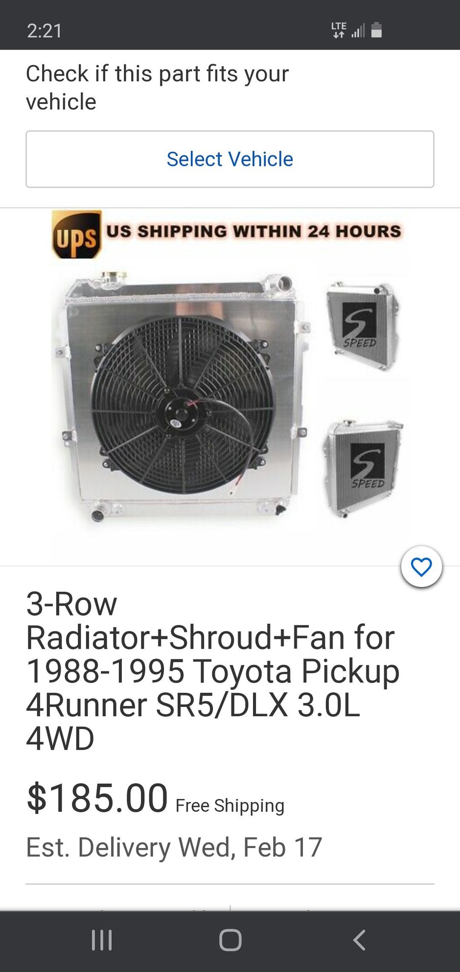

I put one of these in our daughter's 87 4 runner because it kept overheating... that was about 4 years ago.... stays on 190 degrees and has held up well.
