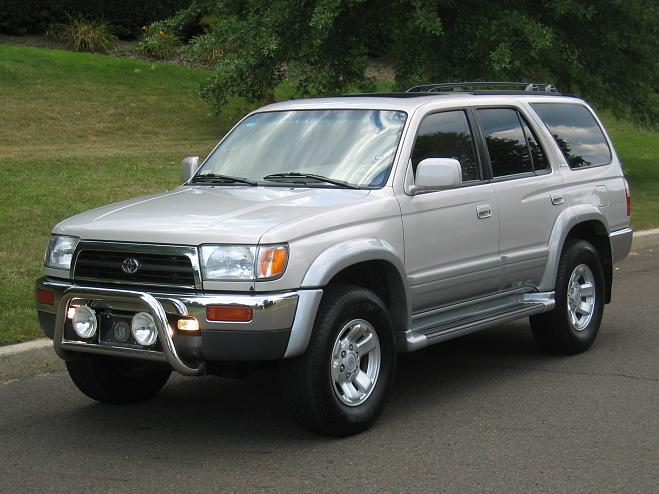

I'm thinking it's time to do the preventative maintenance of replacing my current radiator.
I am not adding an external cooler at this time and intend to use the integrated trans cooler. I have not had a problem with overheating with the standard set-up.
For those of you that have done this, either because of failure or maintenance, are you happy with your replacement radiator? Any install or fitment problems? Poor design? Customer service?
What brand and part number did you buy?
Where?
Thanks for your input. I'll sleep better at night without the radiator failure hanging over my head.
1998 4Runner Limited
3.4L V-6 A/T, 4WD, e-locker
112K miles
(original radiator)
