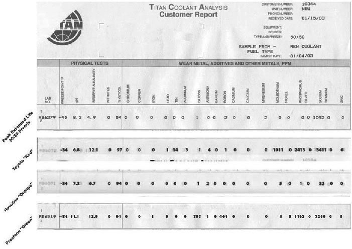

Here's a Coolant Analysis
Note the PH and Moly
Sorry that it's a little small
