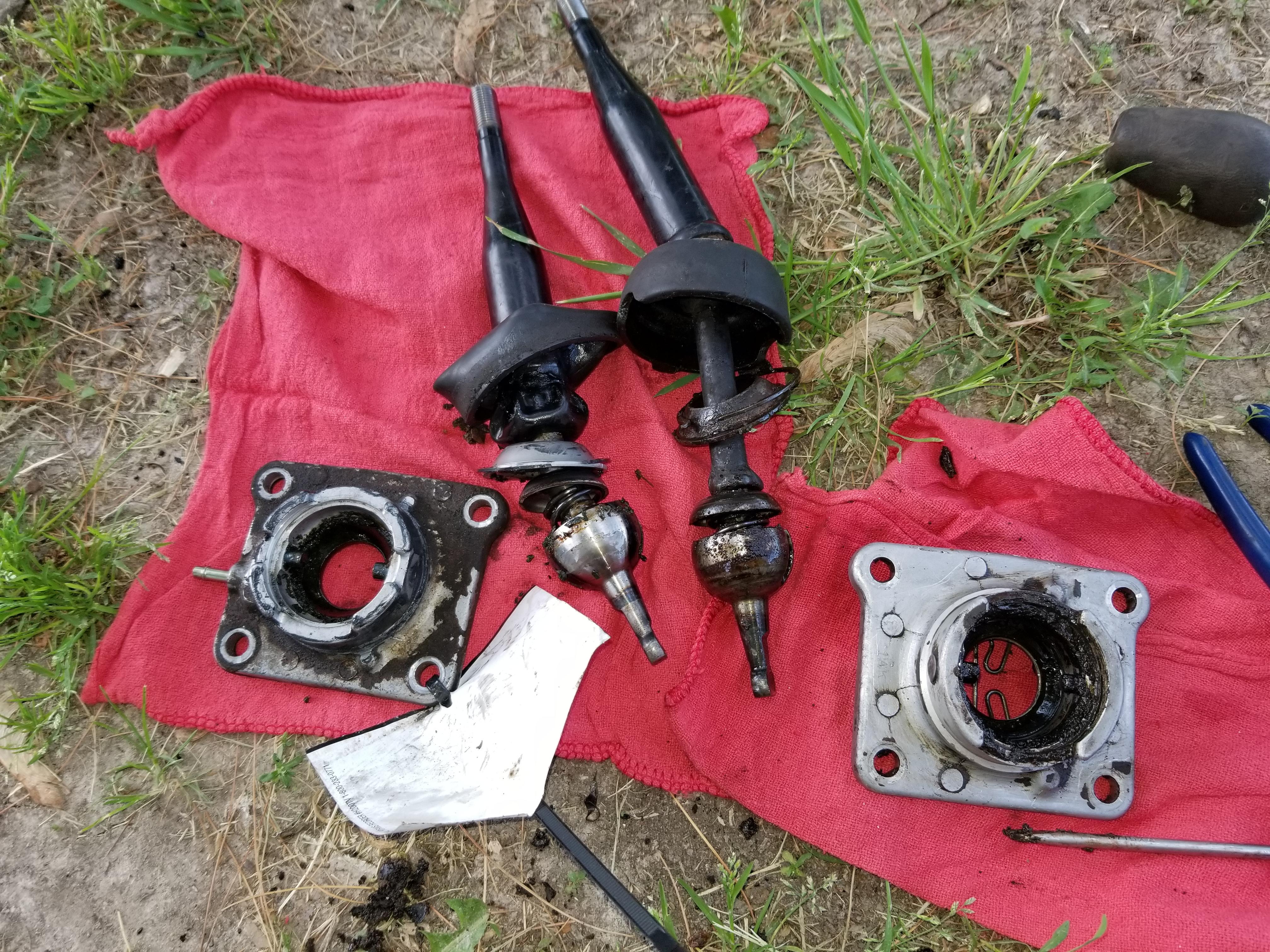

I got mine taken apart. It's easy to see why it broke. The previous owner cut both the transmission stick and the transfer case stick and welded in about 3in of steel. It broke at the bottom weld. I welded it back together for now. That 22r shifter set looks almost identical to mine. I did end up finding a Toyota junkyard in California that had a manual V6 shifter. And another yard had a tacoma v6 transfer case shifter.

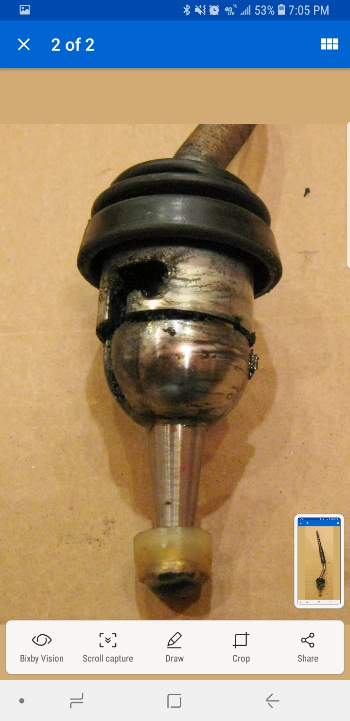

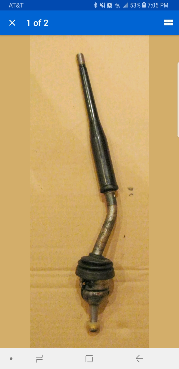

Here are the pictures from the ebay listing for the one I just bought. It looks like everything is the same. Same spin cap, same ball, same tip. Of course I can't judge size from the pictures but it looks like what I need.

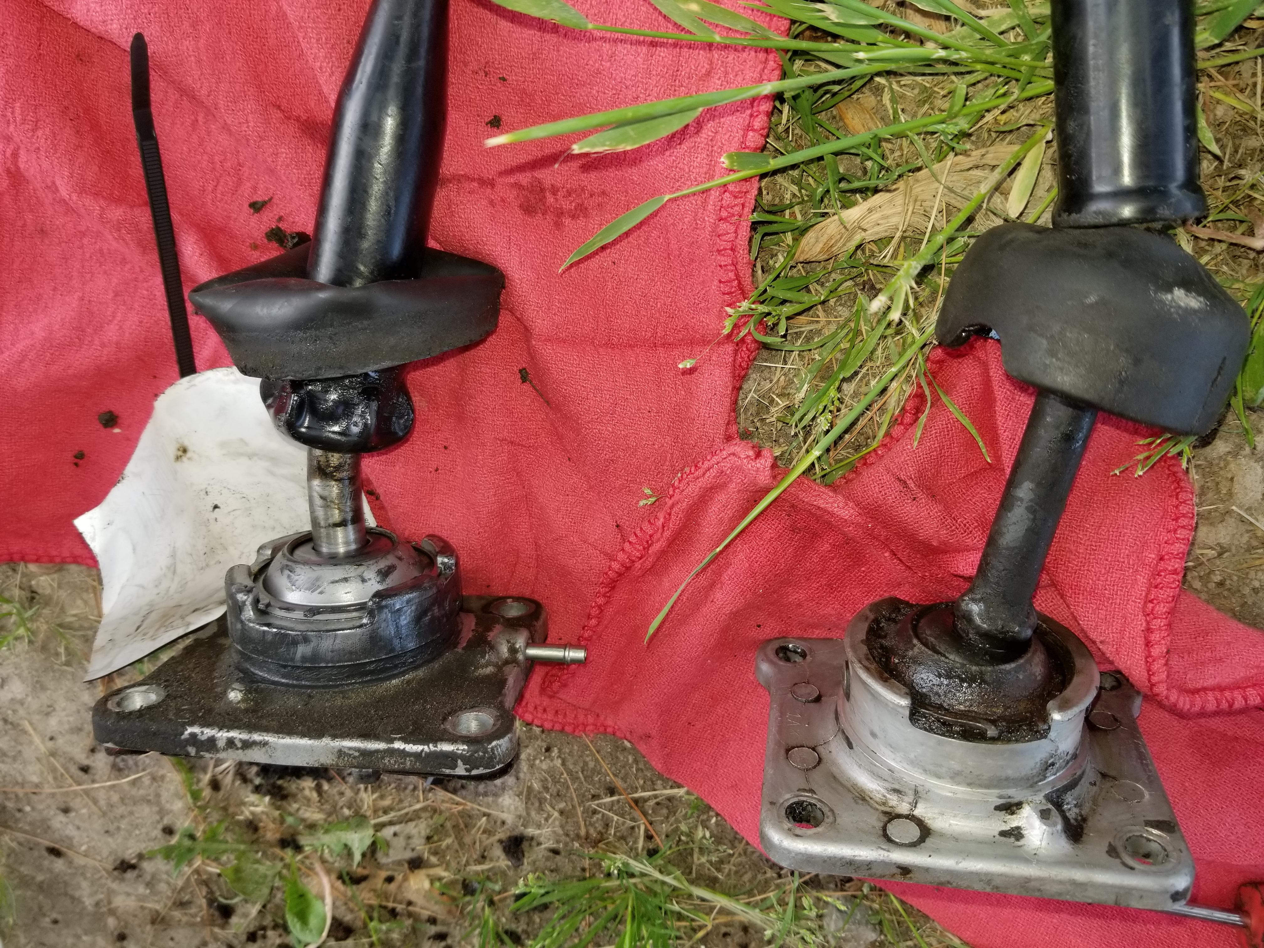

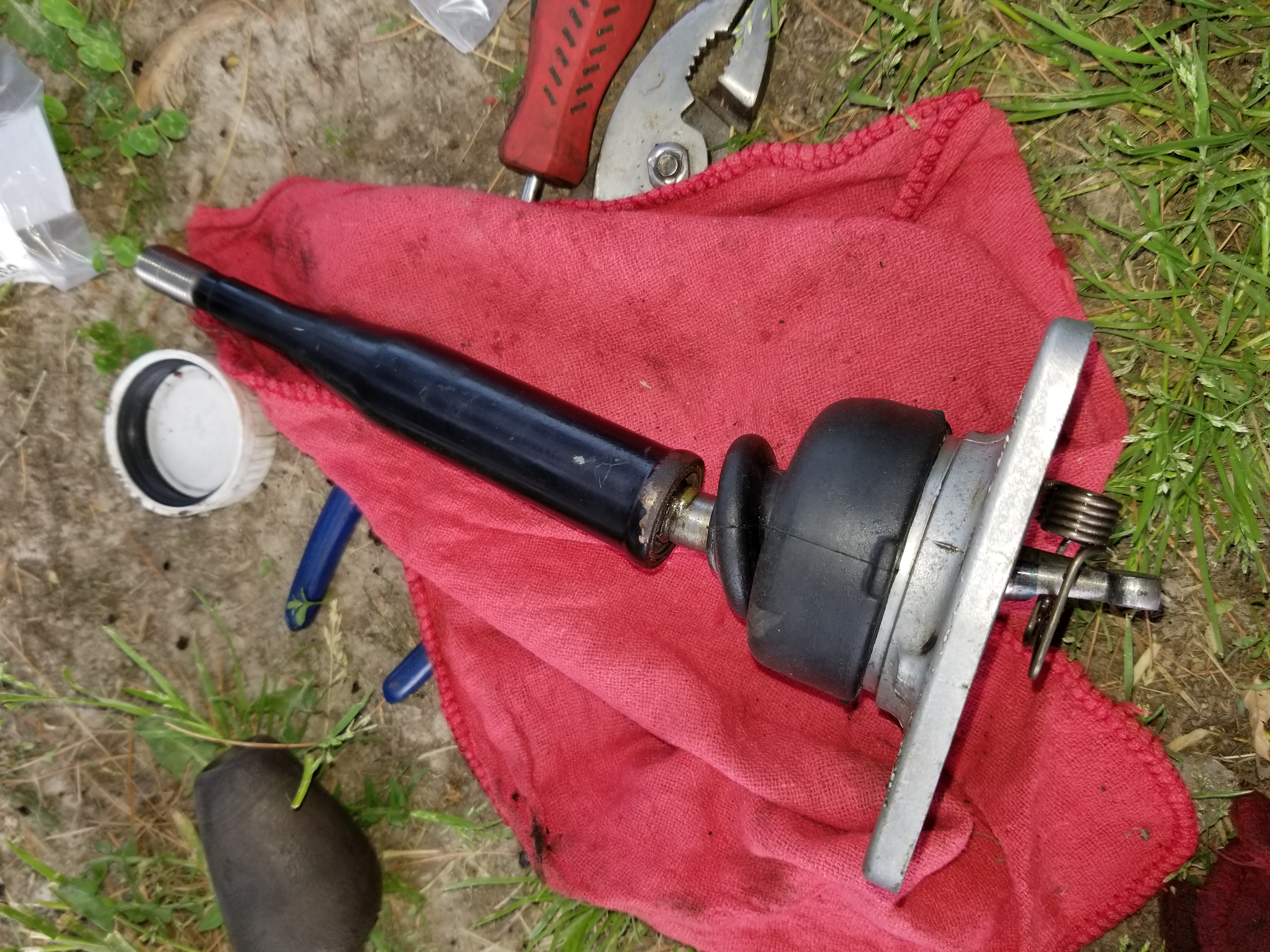

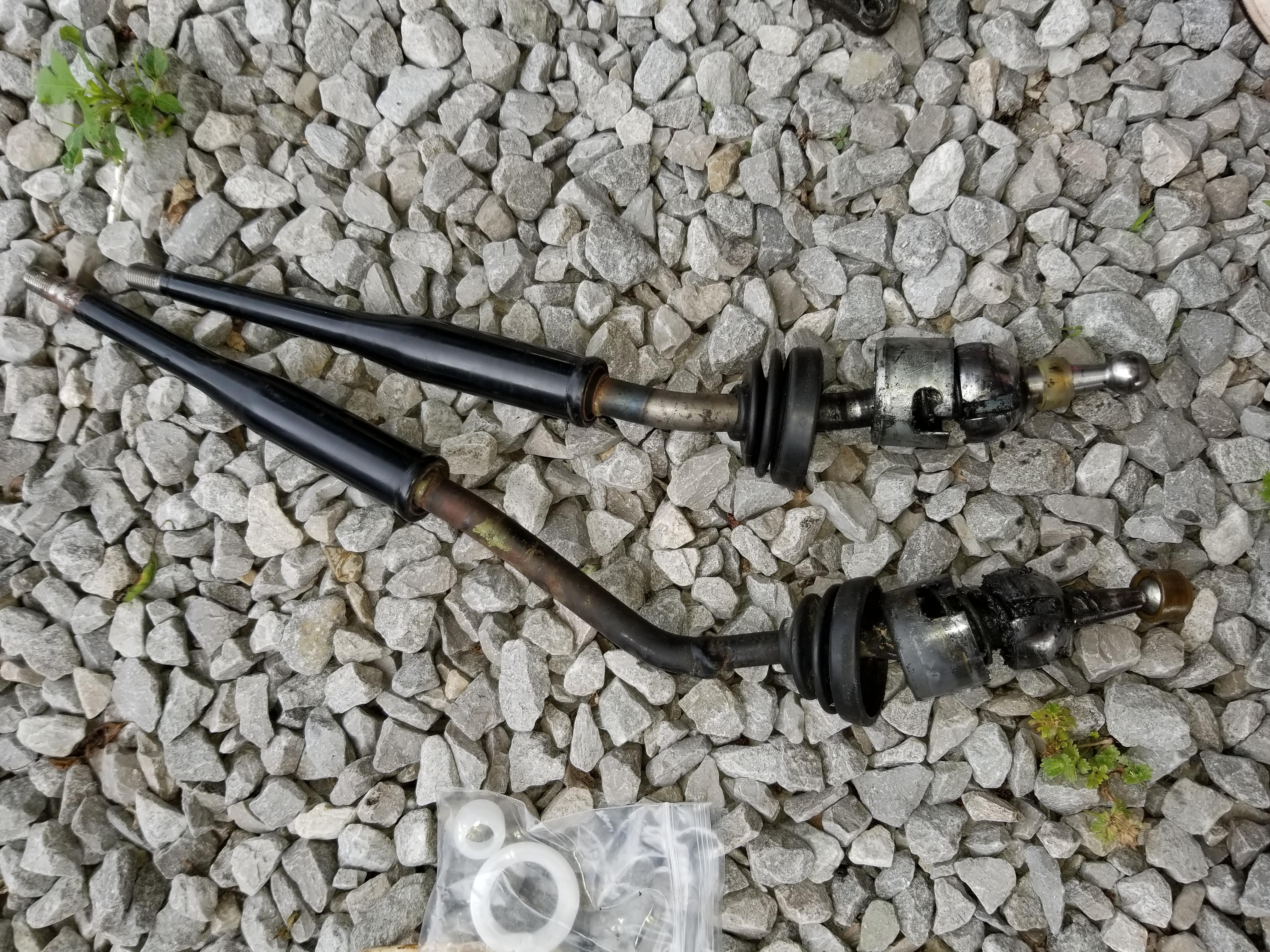

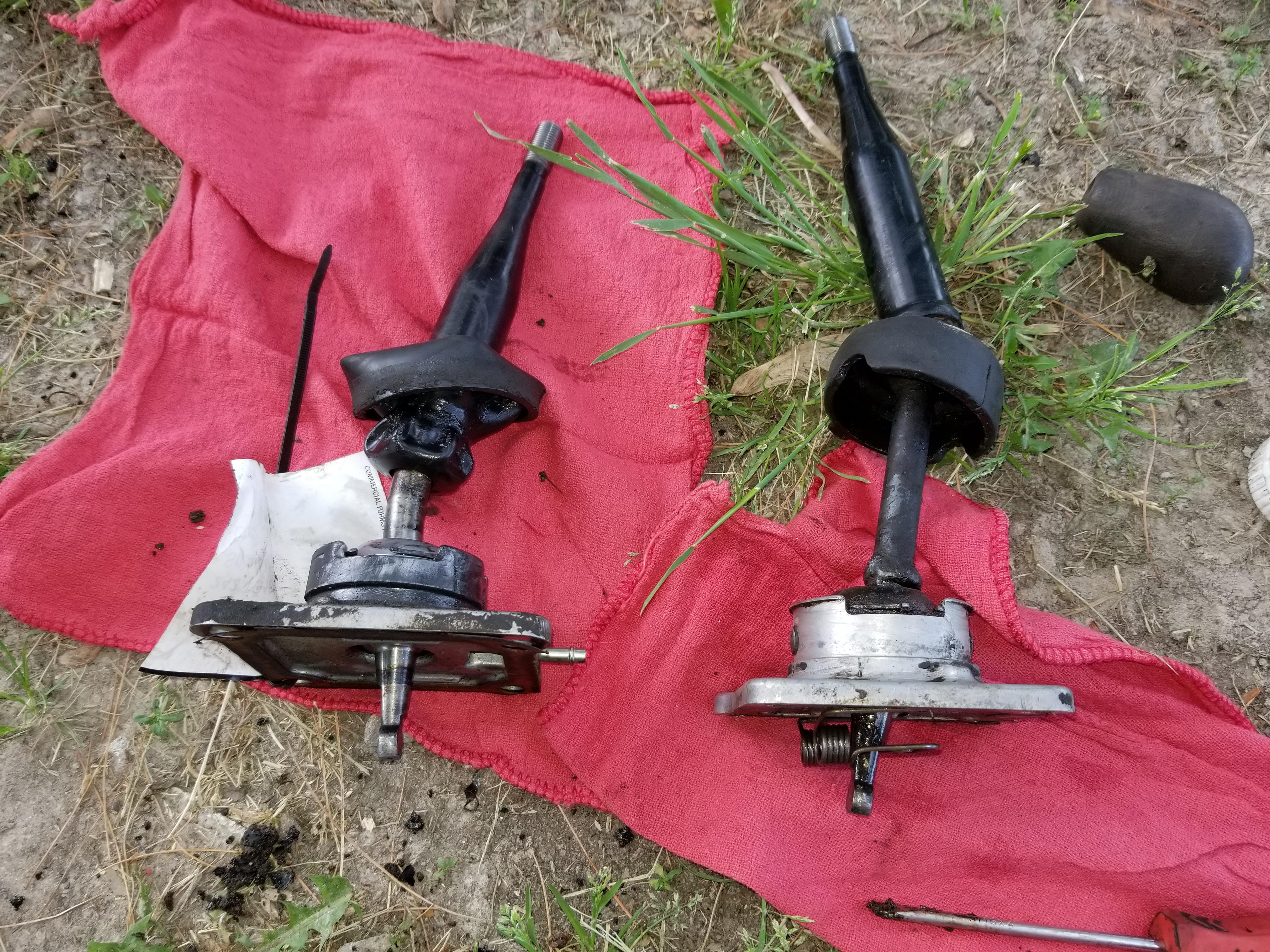

Here are side by side pictures of the transfer case shifter on a 3.0 vs a 3.4. The 3.0 transfer case shifter is the one that has the extension welded in. The only difference I can see is that there is a vent on the 3.4 shifter housing. I re used my 3.0 shift housing so I wouldn't have to block off the vent. I got it installed along with a new Marlin transfer case seat and a new Toyota boot. It works now and the shifter is tight with no play at all.

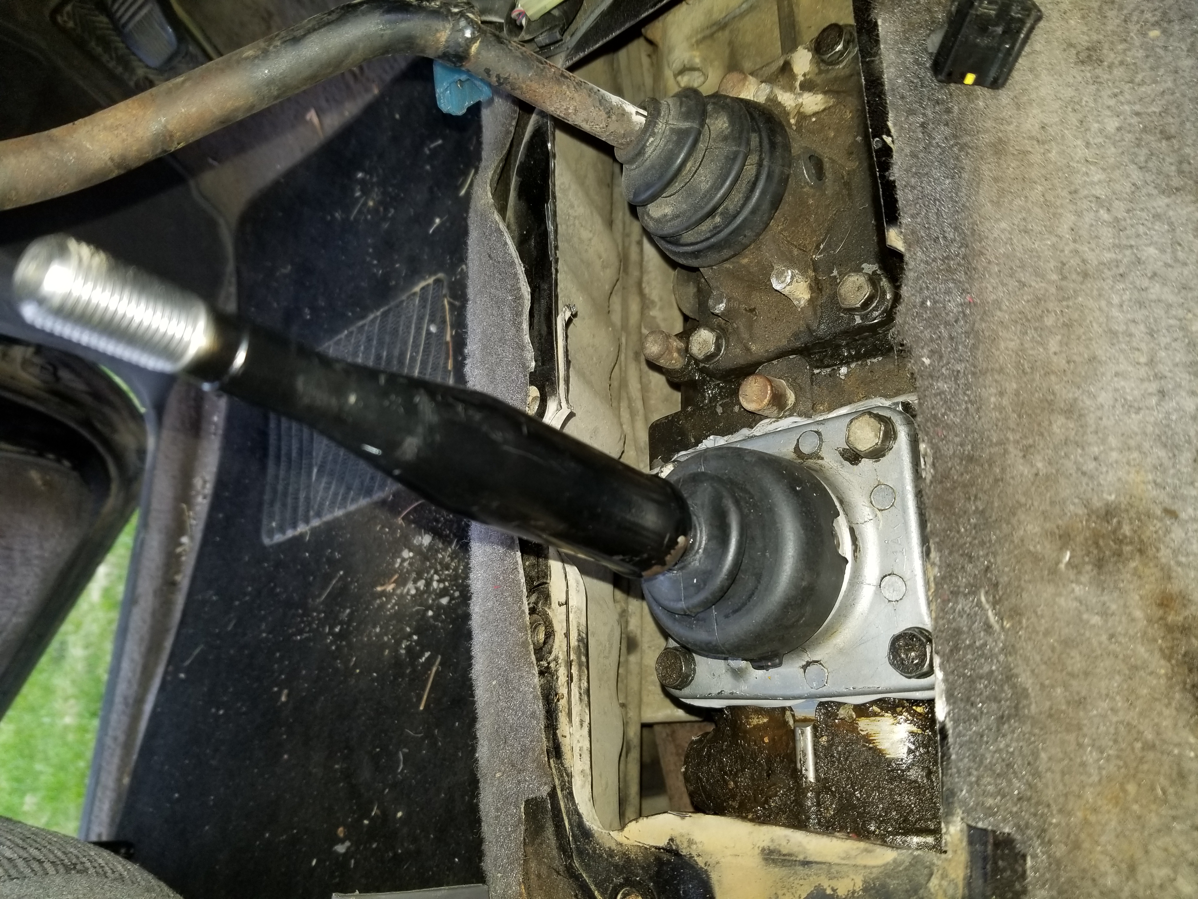

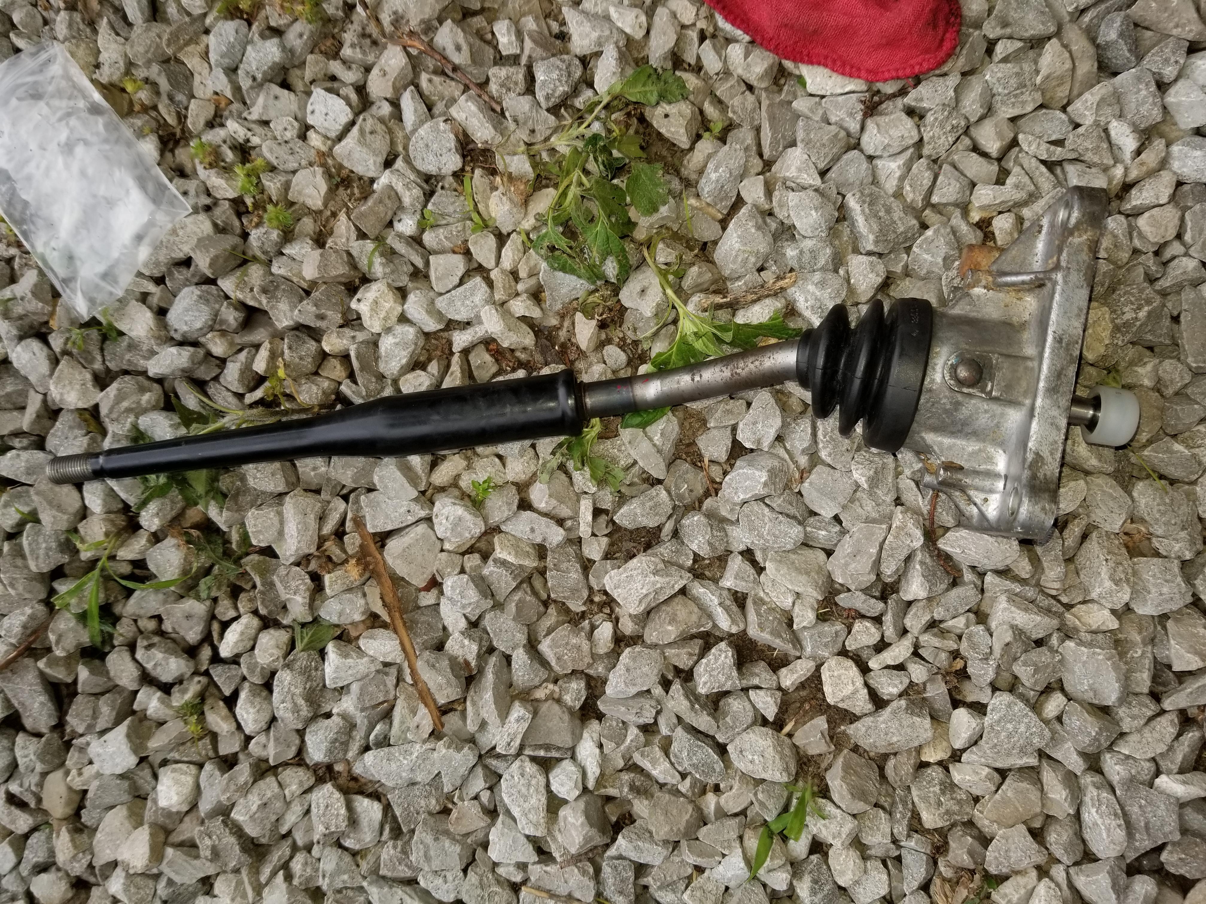

Here it is assembled with the 3.4 lever and 3.0 housing. And in the truck.

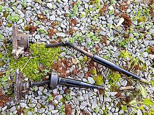

I can now confirm that a W59 from a 3rz Tacoma has the same stick as a r150f from a 3vze. Plus they both look identical to the shifter from the 22r. So it looks like the V6 shifter is compatible with all 1st gen 4x4 tacoma shifters (the 3.4v6 uses the same r150 transmission) or 3rd gen runners.
