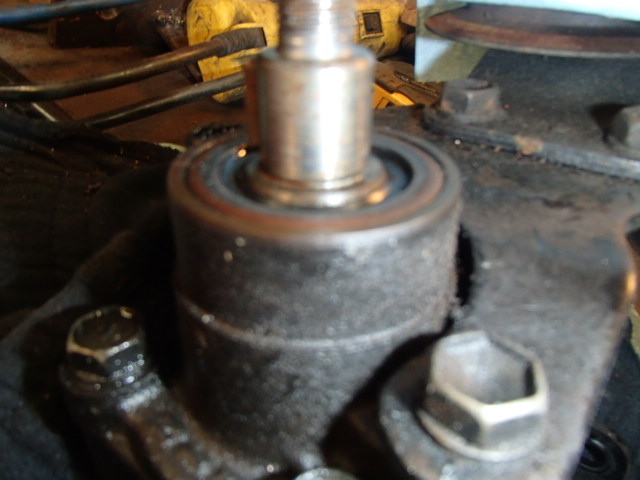

After pulling mine apart your seal is either not seated fan enough or it is the wrong one.
there is a shoulder on the shaft that must protrude through the seal
The welded side of the pulley rides against this .
When things are like this the seal does not touch the pulley and the shaft spins free
I was thinking of the spacer on something else.
If you need a picture let me know and I will try and find the camera

If you can get a photo that would help. I'm pretty sure I got it seated all the way, outer ring of the seal is about 1/16 past flush now. I wonder if somehow the wrong seal ended up in the kit I got

It would not surprise me
You can see the shoulder on the shaft the pulley rides on

finally got a chance to stop by autozone and look at another rebuild kit. Sure enough it had a different seal in it than the one I got. Lucky me, now I get to do it over again this weekend.
