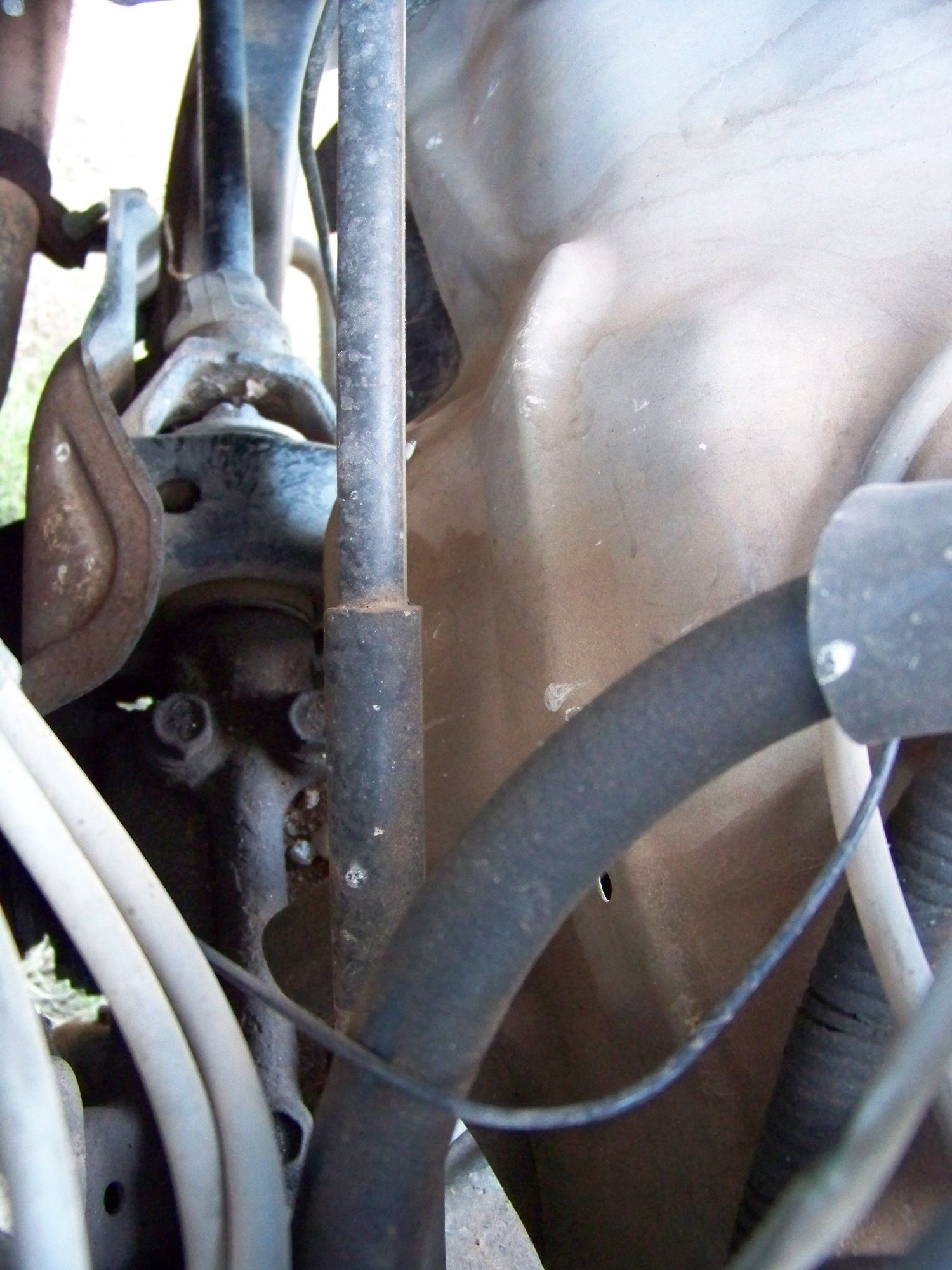

There are early and late model IFS type power steering boxes, looks like you have one of each.
There should be a slip joint in the steering column shaft between the box and the firewall that should expand to give enough extra length to make the shorter box work.
Can you give an image of your column??
I'd double-check what length of the shaft is left remaining in the slip-joint after expanding to insure safety.

I can tommorow. My buddy/ mechanic said it wasn't possible though. Even when looking at the supply lines id have to modify them. They were about an inch off too. We thought about extending the shaft but that would create problems in the future if this one started leaking and I needed a replacement. Even then the two fluid lines were way off

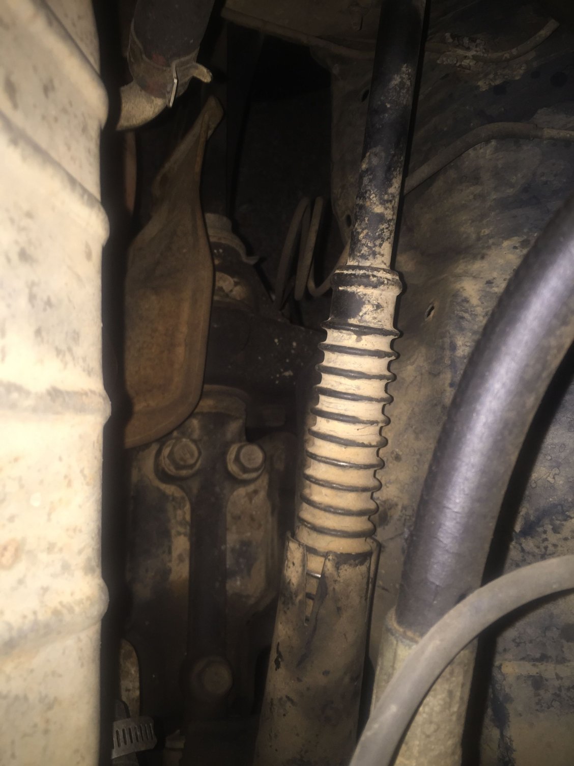

The shaft has a slip joint but it's made out of metal and doesn't expand at all. Looks like it's there to absorb an impact from a wreck. My buddy tried to take his apart, he recommended. It to because its a pain to get it operable again.

Both my '87 and '88 4Runners have the short box, and they also have a simple slip-joint column shaft that would permit easy change of length to accomodate the newer, longer box.
Both my '92 and '95 Runners have the long box and the rigid accordion type column shaft.
Looks like the accordion type shaft is only made to absorb shock and compress in case of collision.
Seems that the early trucks can be easily made to use the later steering box, but the later trucks can only easily accept their original long box.
I don't see any major difficulty in changing the minor spacing differences in the hydraulic hoses. I don't think any new parts would be necessary.
