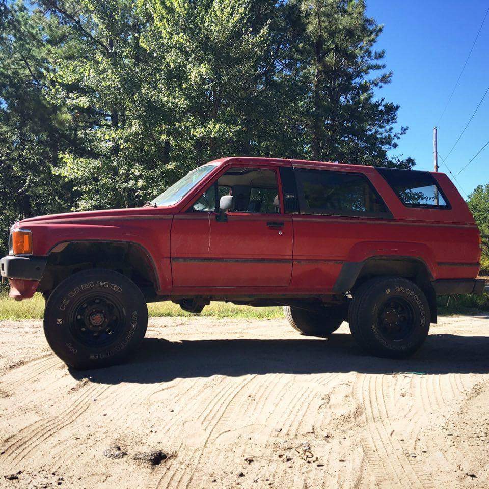

After about 10 years, I finally got my dream truck. Picked up a mostly stock 86 4Runner 5 speed. Truck runs phenomenally and is almost rust free. Will be using this for mud/fire trails and some rocks...with the occasional camping trip. This truck will be built over the next few months and plans are BIG.
plans are as follows : SAS, V6 rear swap with discs, 4:88 gears with ARBs front and rear, bumpers/sliders and a winch up front. Full interior cage, new seats/stereo and beadlocked 37s. Here's a photo of how she sits now and it'll start coming apart next week. Stay tuned!

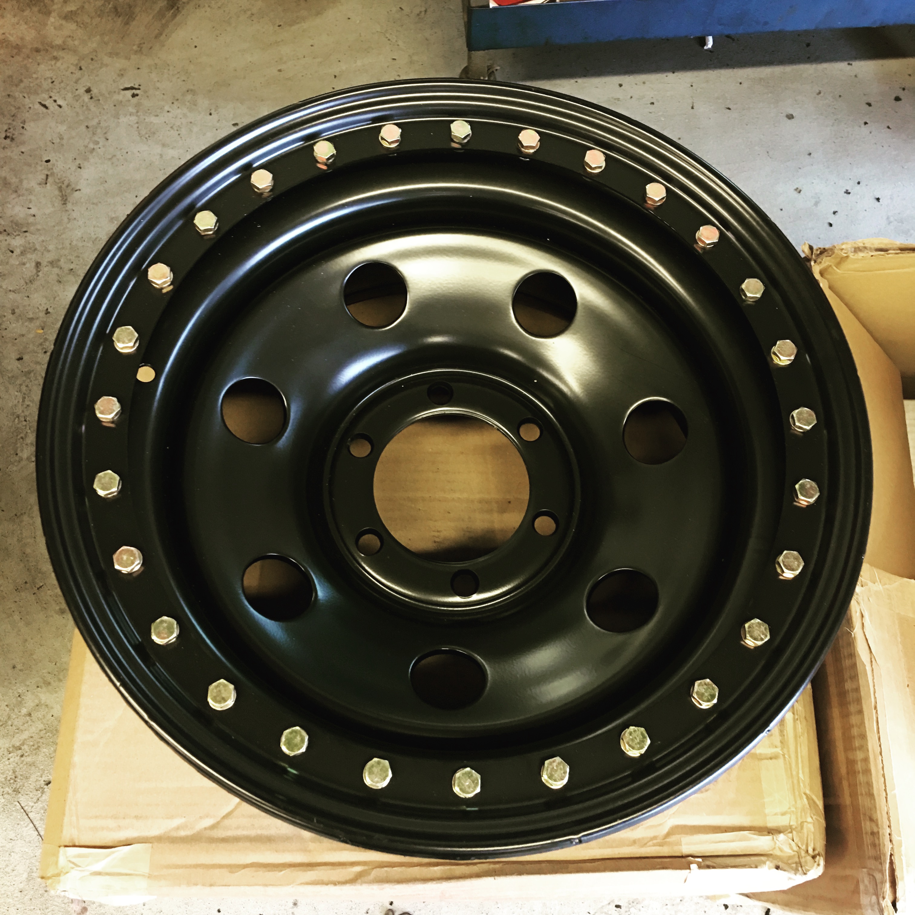

Wheels came in as well. I decided against bead locks because this
truck is going to be driven on road a lot and cops around here know that
beadlocks are illegal so I picked these up. Not a fan of fake bead locks but
these were on eBay for $279 shipped, brand new! Couldn't pass Em up!

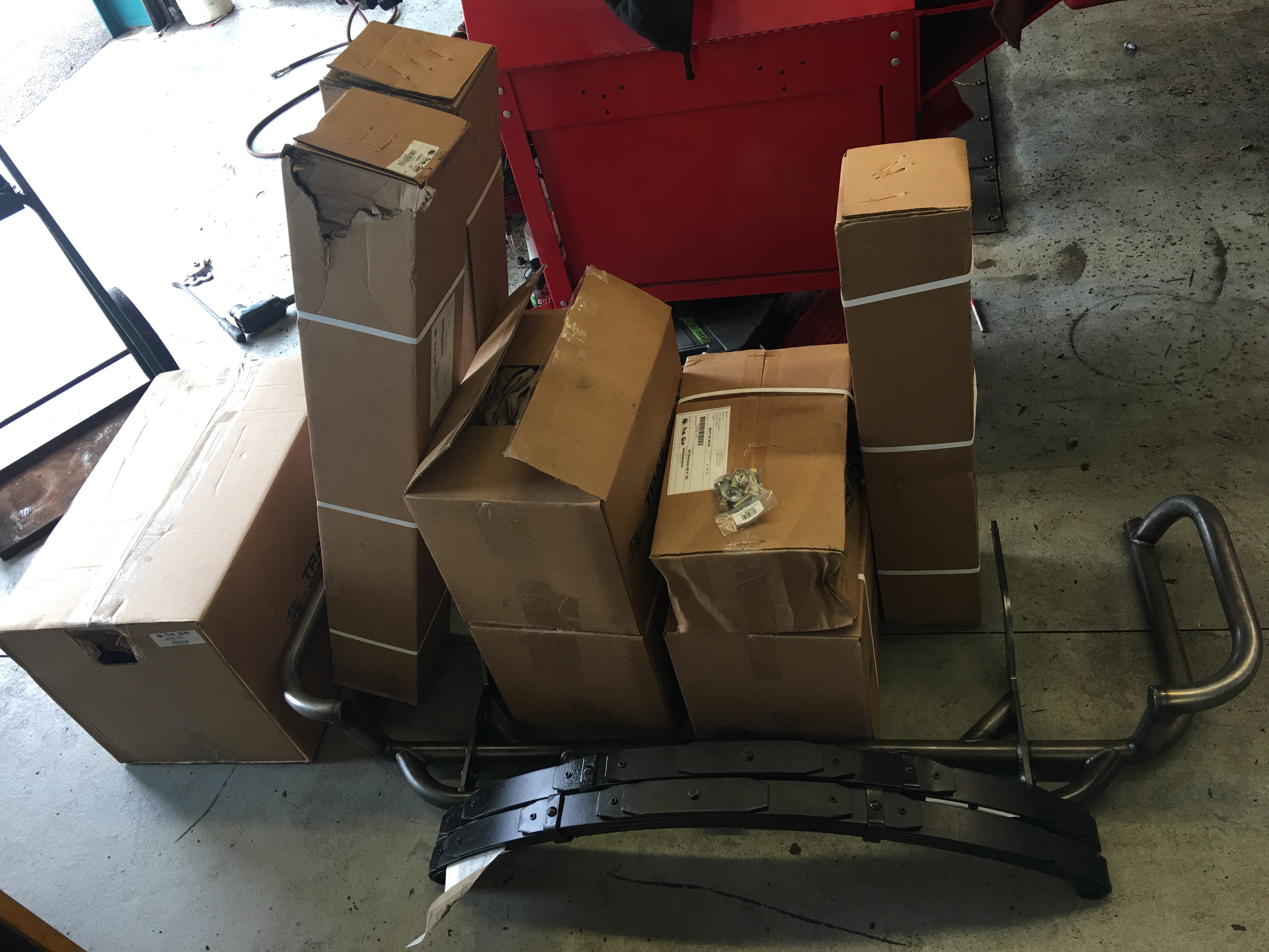

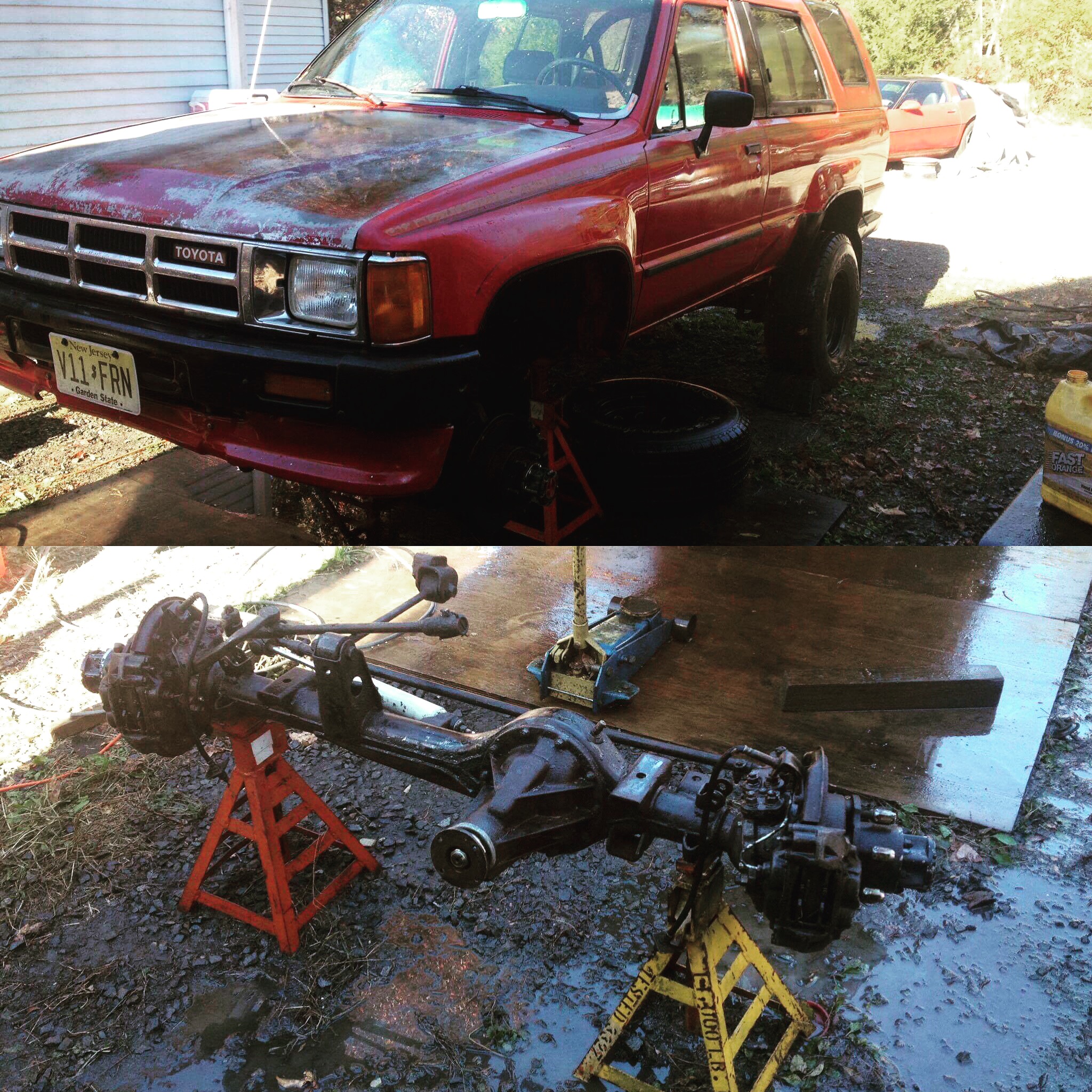

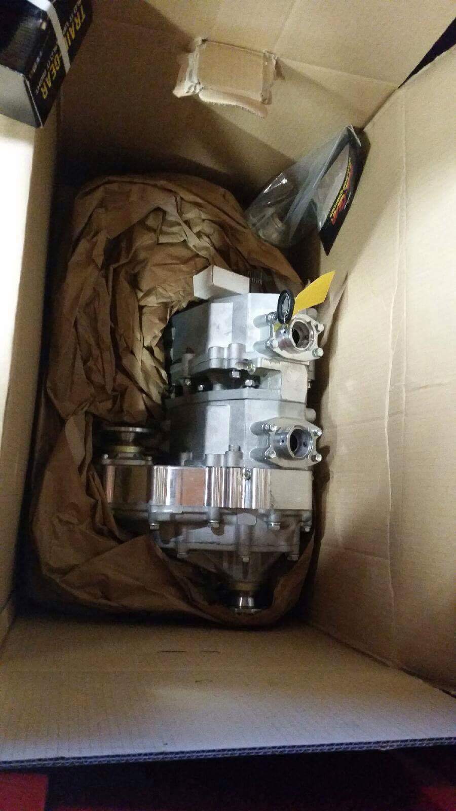

In other news, EVERYTHING showed up. (I'm sure I'll order more soon). I did get off of my original plan of ARBs and went spool rear and grizzly front. I wanted to save a few bucks and invest that in a Dual T-Case. I felt like that was a good compromise.
Also got the truck on jack stands and have started disassembling the IFS. Getting the front axle ready for the SAS.
