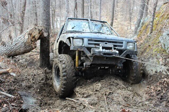

My end goal is something like this. ( I know this is not with the TG mount)
Thats my truck on the left. Bumper I want to mimic on the right.
Lets see what you have. Any home made front winch bumper pics?

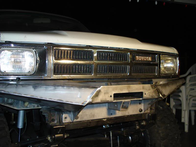

This ones pretty snazzy, but looks like more work than I want to put into it
My thoughts are get the winch mount and get my winch (fixed), then on it so It can be used instantly. Then, when I have the time to make the rest of bumper, I will.

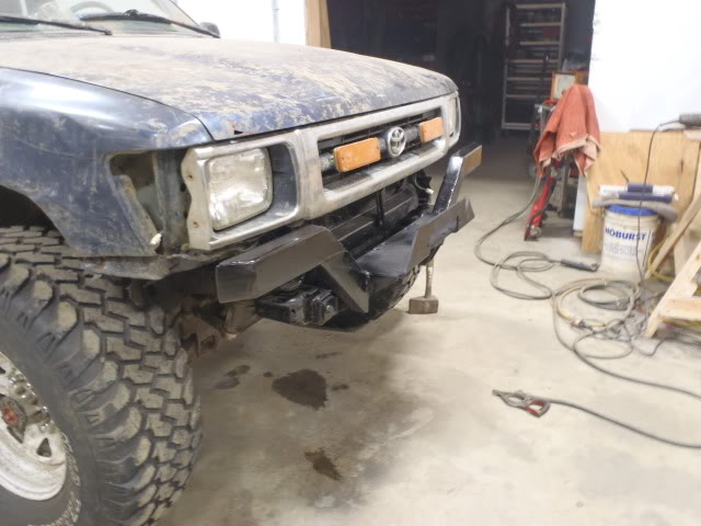

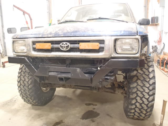

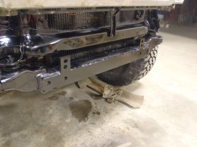

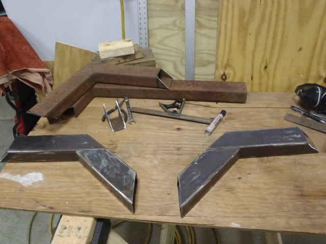

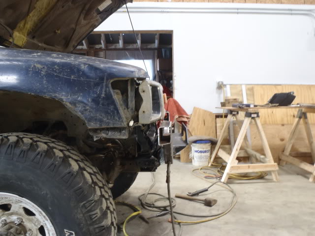

So this is what I ended up doing.
4xI frame brace:
And fully boxed and painted

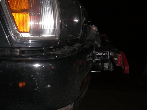

Looks a lot better with the winch in there minus my bad grill cutting job:

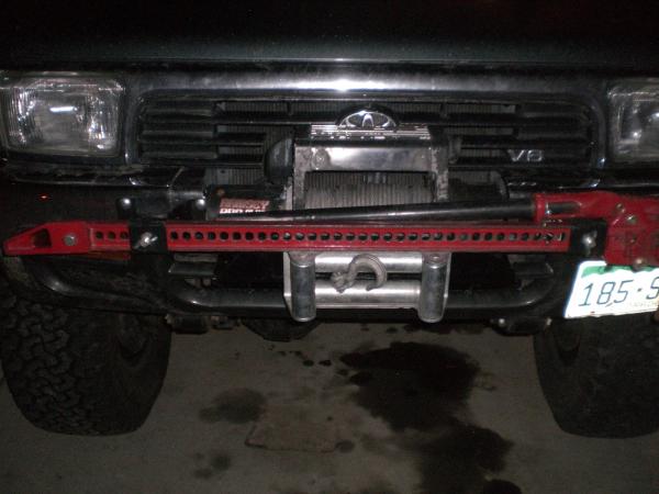

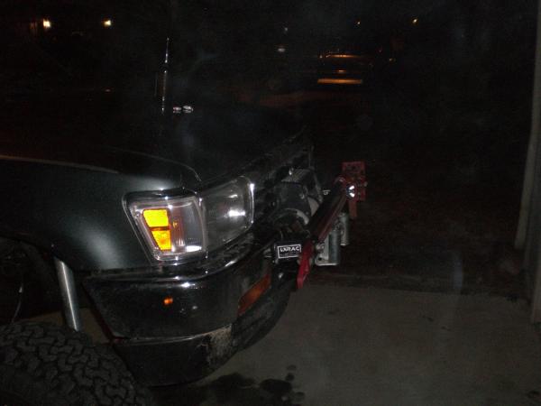

you coulda just done this. the trail gear plates in there somewhere. lol
Attached Thumbnails Post pics of your TG winch plate based bumper.-winch1.jpg   Post pics of your TG winch plate based bumper.-winch2.jpg   Post pics of your TG winch plate based bumper.-winch3.jpg

Thats a pretty sleek design. Almost looks stock! But my stock bumper is trashed...not worth saving
I hope you dont ever hit anything...bye bye highlift...

That looks really good, Rattle. Are you going to add more protection for the winch? Seems like the winch cradle sticks out really far without any support or protection. Yes, its 1/4", but that can still bend very easily with a 2 ton truck behind it

I like that, good job rattlewagon. Did the frame brace come from TG also?
Not sure about the turn signals and lack of marker lights though, that might be a ticket magnet in my state.

thanks its only temporary til i get mine fabbed up. yours is simple and effective. i would recomend a triangulated support going from the left and right "wings" back to the frame, i could see them bending in a collision.
you could even make it a bolt through design utilizing the four shear bolt locations for heavy pulls

4xInnovations made the brace. Its pretty beefy. I think addicted offroad makes one too.
Im not worried about the winch mount bending, that partially what the frame brace is for. It might get some side support down the road though like MP suggested, but will do for now.

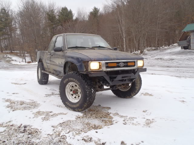

Welp.. Mines still going strong.
Only thing I changed was the switching the roller fairlead out for a hawse one so I could use the hitch mount at a recovery point. And some minor bracing on the side pieces.

Very minimalist style. Simple yet functional. What'd u spend on the mount plate and where did u buy it? Best price I've found is from bytortruck.com
