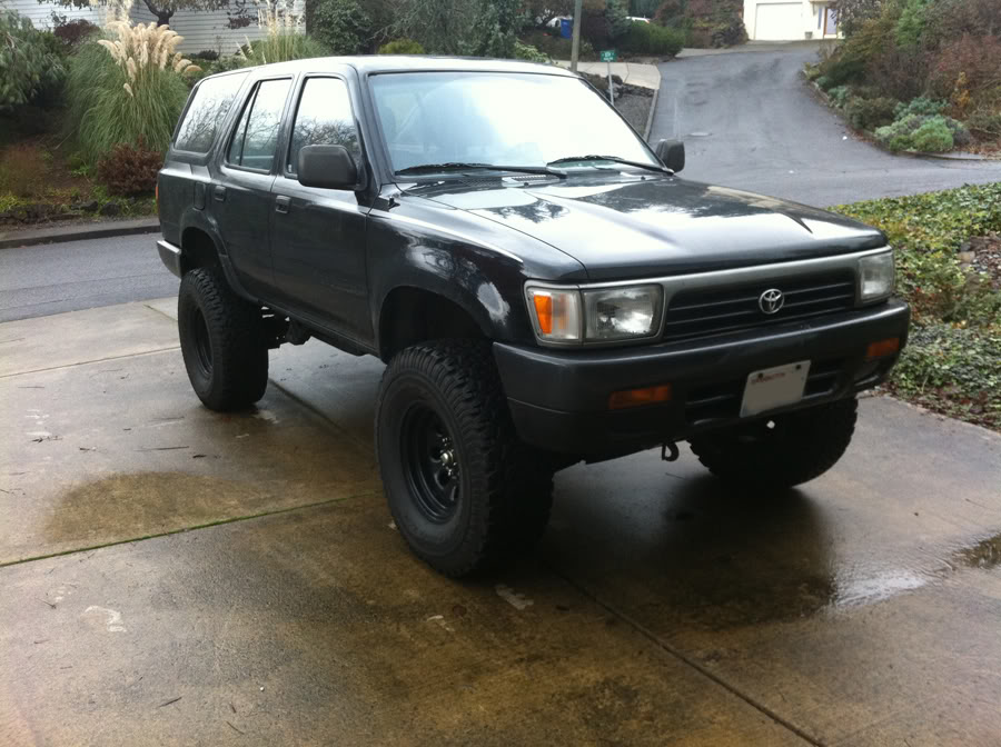

Contributing... See signature for details and build thread.

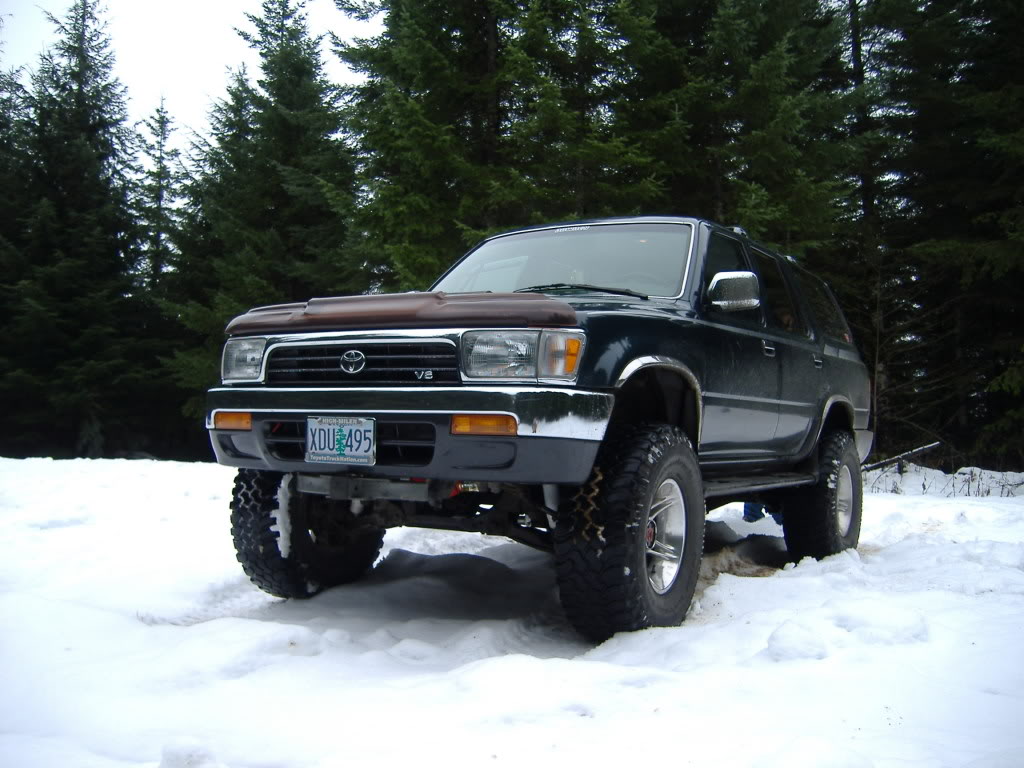

Took the 4Runner out for it first run with the new suspension system installed. I am very impressed at how well it did, and how smooth the IFS was even compared to stock when I hit the pot holes.

nice pics!
Old Nov 30, 2010 | 11:15 AM
  #170
jbuck07's Avatar
Joined: Oct 2010
Posts: 83
From: japan
sweet tires on 904 runner. i like that bumper too

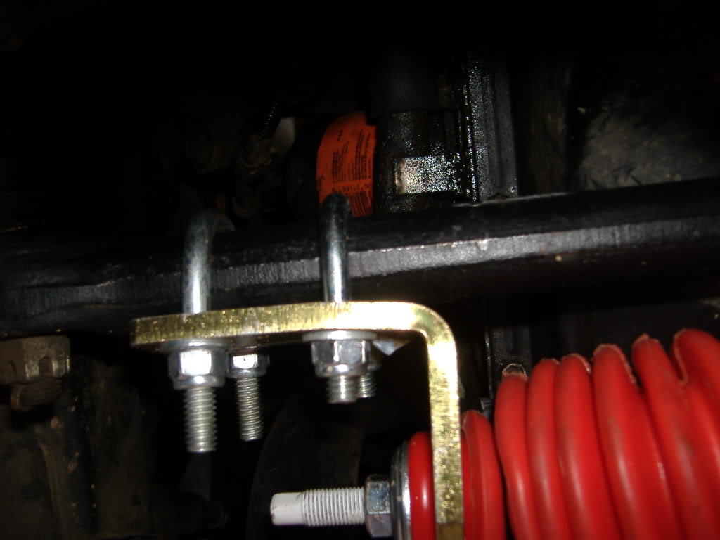

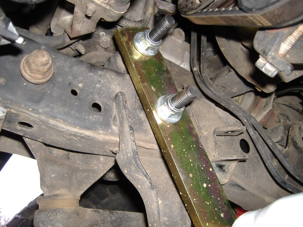

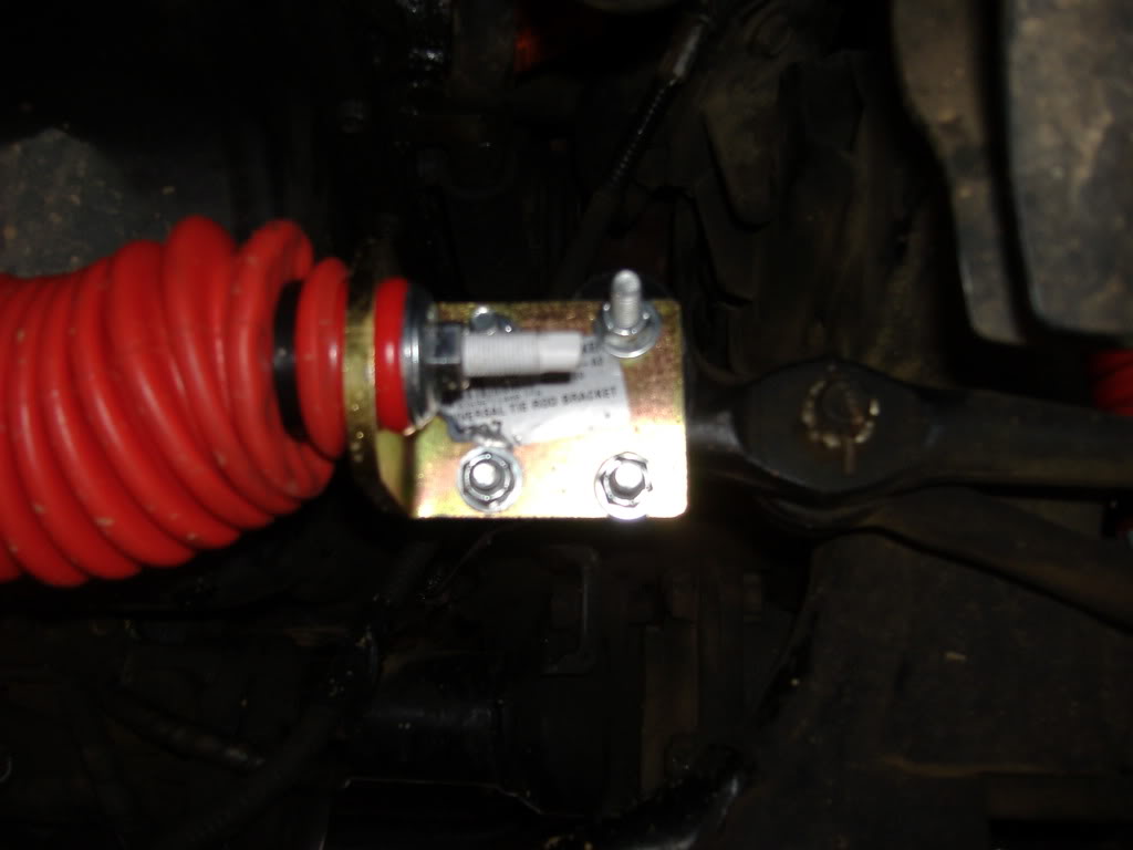

Originally Posted by 85toyman
Post pics on how you mounted your steering stabilzer.

James D
Here are some pictures I took of the stabilizer. I used the kit from skyjacker. The long bar is attached thru the back two holes on the idler arm connected to the frame. The other end was a little more difficult. I needed to place the bracket with the ubolts right where the old shock mounted. The old unit has a hole right there and the ubolt was too small by a fraction to fit thru the hole and around the bottom side of the relay bar. I went down to the hardware store and bought the next size up ubolt and it fit thru the hole on the relay bar and into the bracket for the stabilizer. If you have more questions let me know.

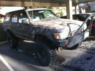

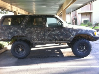

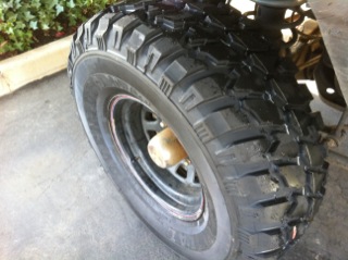

93 with4.88 gears and pro comp 4" lift with 33x12.50. looking to trade this rock smashing bumper for a stocky and a skid plate.. just sayin lol camo paint is going away soon..
