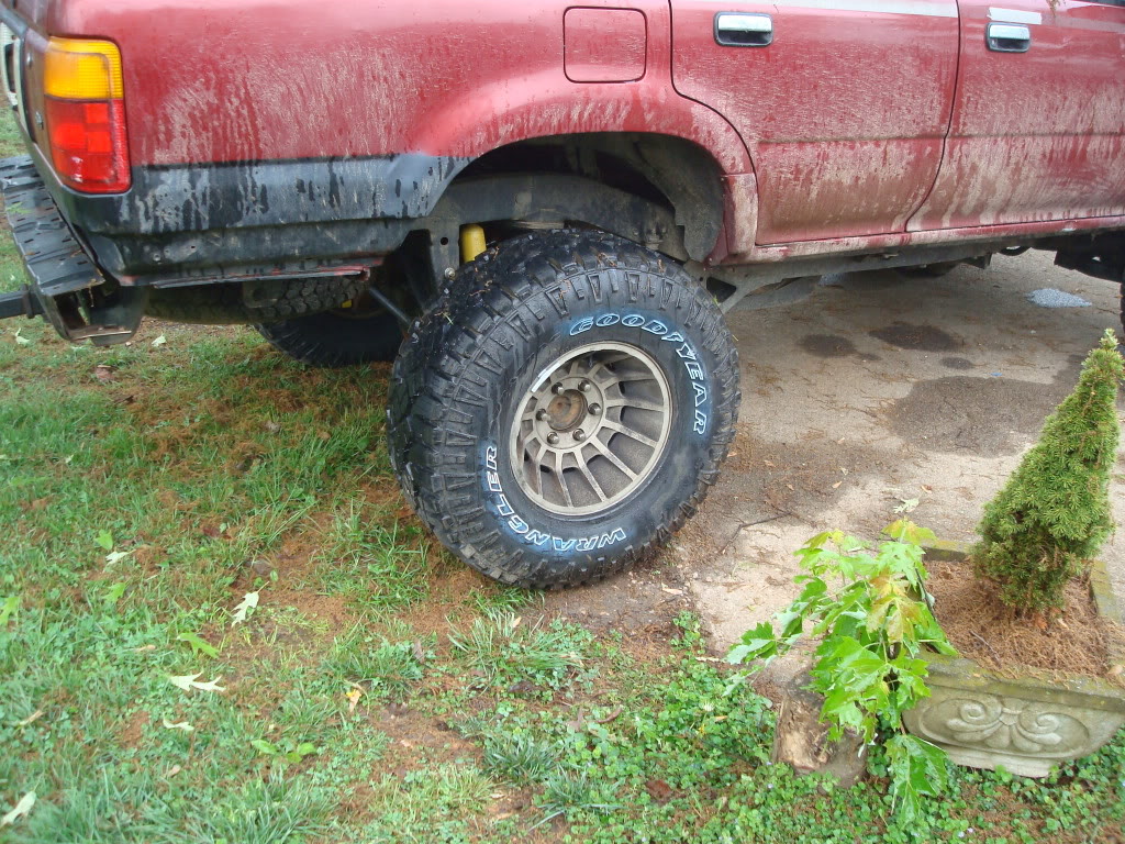

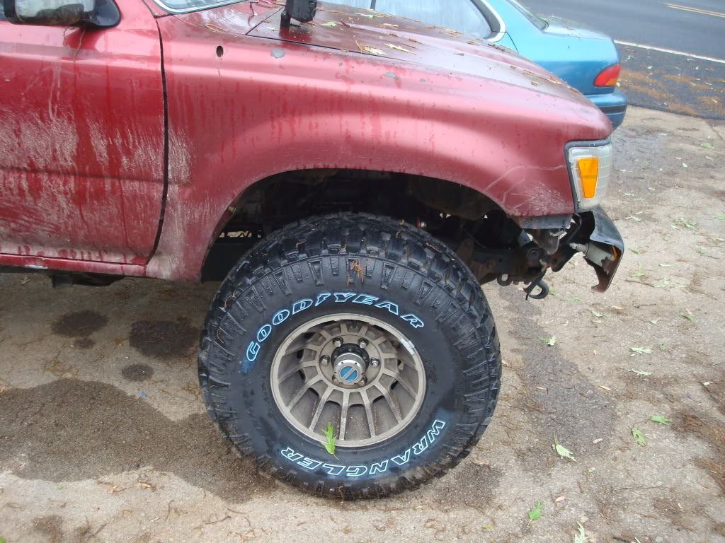

Oh, and here are some pics... working the T-bars over, and Pro-Comp springs in the back.

She asked me how much it would cost to lower it?!?!?!
