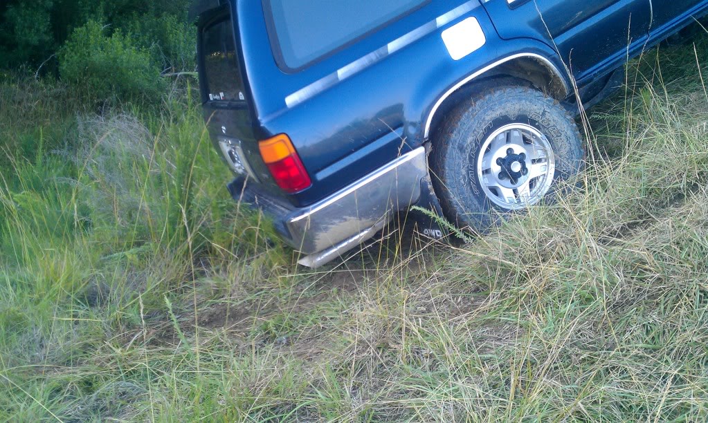

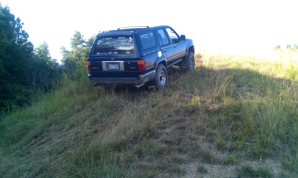

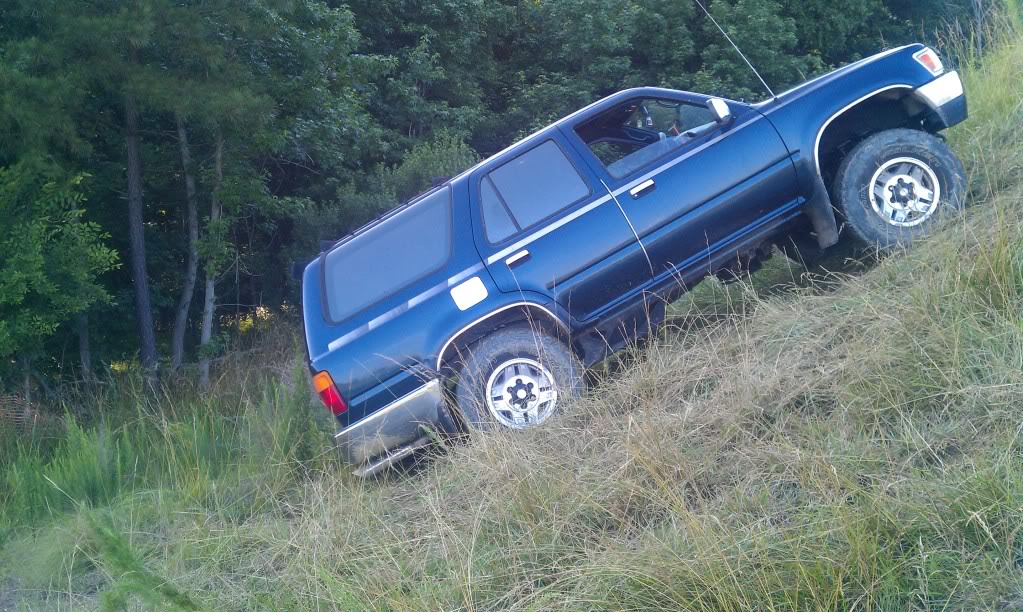

eek... dual exhaust on a 4Runner? You'll smash those tips and find out why its such a bad idea at some point

Thanks for the jinx...lol, they are tucked in with the hitch pretty tight, about 3/4" clearance from it... But I do have a protection plan in mind for them. Similar trick I used on lower work lights of the 40 ton wrecker I operated before my curent job. Weld a box to the hitch to guard them from lower impact. It still has open diffs for now, and no winch, again for now... So I dont do too extreme of activities with it yet.

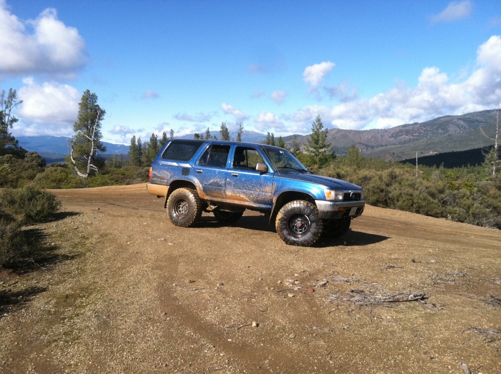

Whuddup dudes!
Here's a pic of the runner in my sig.

Like your set up man!!!
