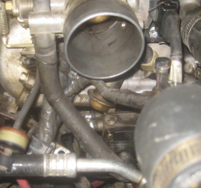

Ok, I got a few shots of the offending part. It appears to be on the end of the fuel delivery pipe. I even got a shot of the underside of it where the fuel is coming out. It seems there is a hole there so I have to assume its some sort of valve designed to bleed off pressure. I guess the question is, why is it releasing fuel? As discussed previously, there was uncertainty about the hose connecting to the valve at the other end of the fuel pipe. Did something go wrong here? I'm hoping someone knows how this is all supposed to behave.

That is your fuel pulsation damper and there are 2 copper spacers that fit between the fuel rail, metal tube and damper. The damper is like a bolt with a hole through it for the fuel to flow through one spacer is near the head of the damper and the other spacer is between the fuel rail and the pipe that the damper goes through then the damper threads into the fuel rail. So what you have is the damper then a spacer then the pipe that the damper inserts to then the other spacer then thread into fuel rail and tighten. No fuel should be leaking out.
