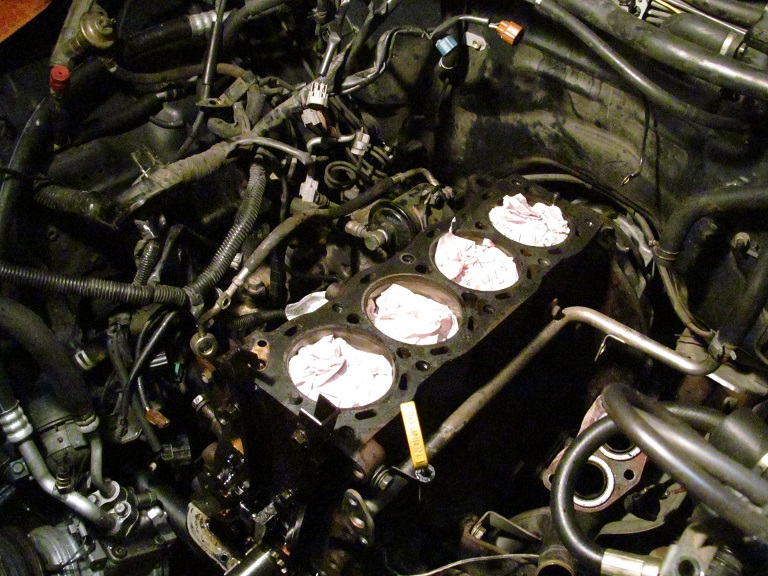

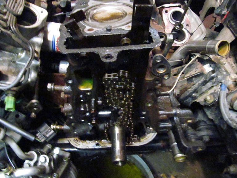

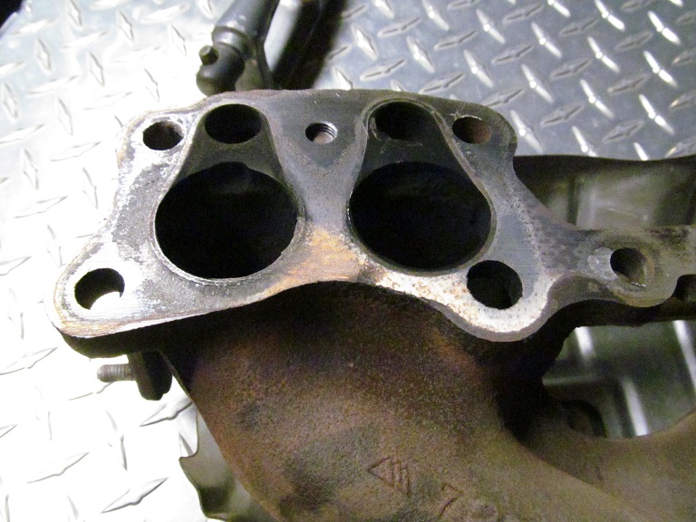

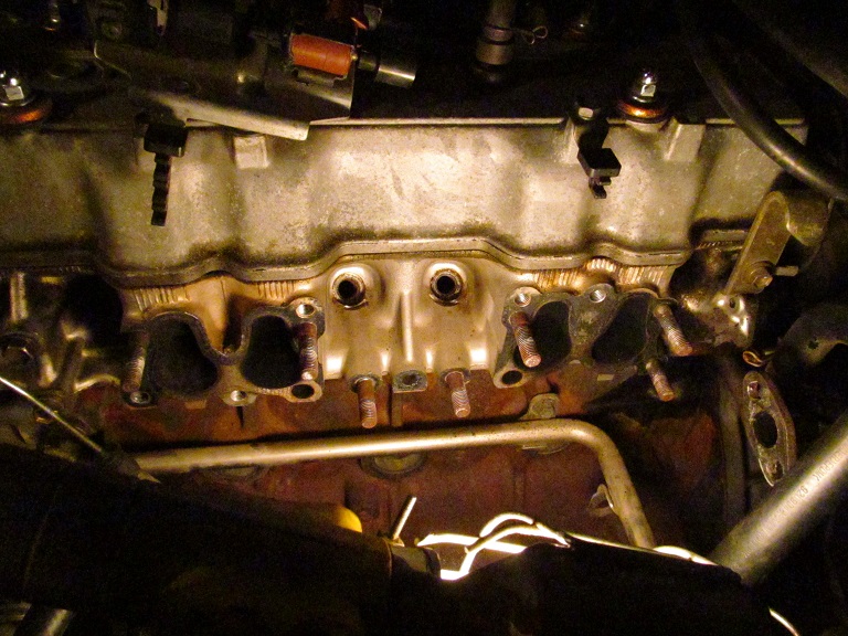

Here's the picts, spark plugs look good as do all the exhaust ports, just #6 still looks like it had an exhaust leak.
see the leak at the rear, since the ports look normal this kind of makes me think tightening the manifold bolts down to much might not be the cause, so HOPEFULLY it's just a head gasket

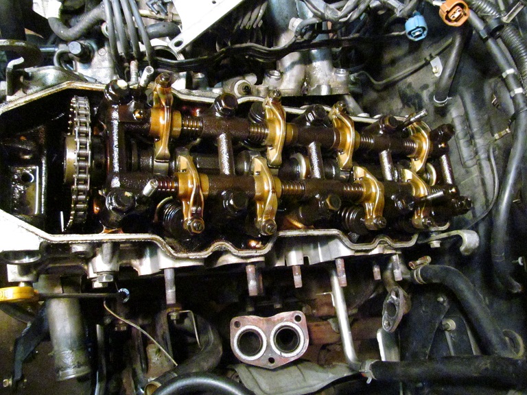

Could be electrolysis as I rarely drive the truck, less that 3,000 miles per year and that's pushing it. Been driving it about 400 miles/ week for the last 8 weeks on the interstate. Nothing obvious for the leak but the back of the head at #6 has very dark spots on the gasket which just so happen to correspond to the area where the block was damp. I just need to make sure that it is the gasket that failed and not something else. The truck ran so well there should be no need to do any thing by way of valves. I would just like to have the head cleaned and very thoroughly checked. I need to be 100% sure that the issue is fixed as pulling the head is one PITA.
Not to much water in the cam cover-

Guides are in one piece and look good also, but will replace with steel rails-

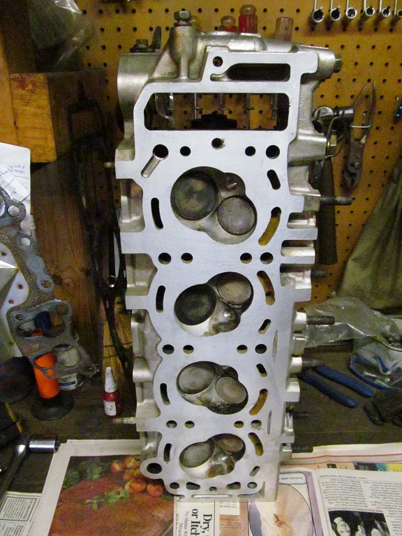

Suspect area of the head-

It is hard to tell from the pics (I even went to photobucket to try and zoom in), it may just be the angle of the picture but the water passage at the 3 o'clock position in the bottom picture "Suspect area of the head-" looks like it maybe pitting out into the cylinder portion of the head. This would give you bad head gasket indicators, and possibly could give you intermittent bad head gasket indicators (as the metals and gasket expand and contract throughout the heat cycle).
I am in the process of reassembling my engine now after a rebuild because electrolysis pitted out the water channels in the same spot. I realize no two problems are exactly the same but I also didn't have milky oil, and pressure, compression, and leak down testing were fine. Intermittently the radiator system would start blowing antifreeze out of the overflow from the reservoir. I was totally stumped along with every mechanic or friend that looked at it. I bought an exhaust gas tester from UView and found that I had exhaust gas in my coolant/antifreeze. This led to me pulling the head and finding the pitting.
The pitted areas on the water passages of my head were slightly more pronounced than your's but the gasket looked really good. It was starting to discolor slightly in the areas were the pitting was occuring (where the cylinder area was beginning to meet the water passage.) but it wasn't obvious on first pass looking at the head gasket alone.
I would look at that area closely and as you recommended get a machine shop to look at it. From the picture it looks like a lot of the gasket material is still on the head. Have you removed it and looked at the mating surface/deck portion of the head?
If you go for a new head I would recommend Engnbldr or LCEngineering they both seem to sell quality non-Chinese castings (Engnbldr = Argentina, LCEngineering = Taiwan?). Both have been recommended in lots of threads throughout YotaTech and ToyotaNation.

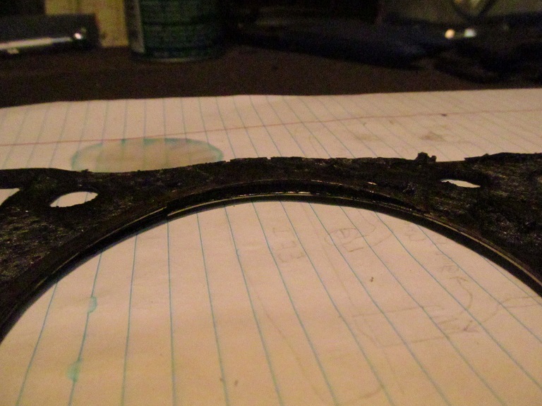

Wasn't sure where the failure was as I just wasn't convinced the failure was at #4. Did more research spoke with a knowledgeable person and finally found the problem. It's obvious now!! I took a closer look at the pistons and noticed #1 was pretty clean. The combustion chamber was about 50% cleaned off....i.e. no carbon. Other cylinders were just a little dirtier w/ soot. But all the valves, plugs and exhaust ports looked the same. It may have just been harder for me to see as the truck wasn't driven very far while smoking. I now look at the picts and see it easily. Luckily the head gasket was carefully removed and came off in one piece. It was easy to spot, the fire ring on #1 was split.
The plastic timing chain guides are in very good condition (123,000 miles) but are being replaced w/ steel guides. No groves anywhere. So best case scenario for the repair. I still need to drop the oil pan as it needs to be cleaned out.

The head is good. Just had it resurfaced, water pump is fairly new, so all that's being replaced are the chain, guides (steel), gears and all necessary gaskets (Toyota), fuel filter as it's one PITA to get to when engine is all in one piece.

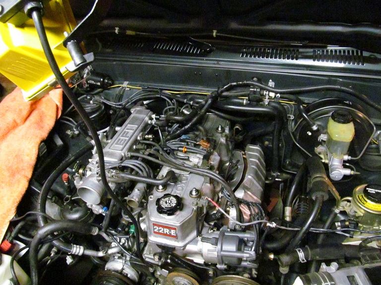

It's been back together for a while now, had two leaks, upper radiator hose not tight enough, and the coolant line under the exhaust had one loose bolt. Also had idle issues, idling at 1,200 RPM's warm, but just didn't know about the air screw adjuster. Timing was at 10 degrees and not 5. New plugs, rotor, distributor cap, dreaded fuel filter, and readjusted 3 valves. Now it idles very nice at 750 rpms, very smooth and strong.
I filled with cheap 10w30 and seafoam, and will put a couple of hundred miles on the truck then do another oil/ filter change w/ good 10w40.
