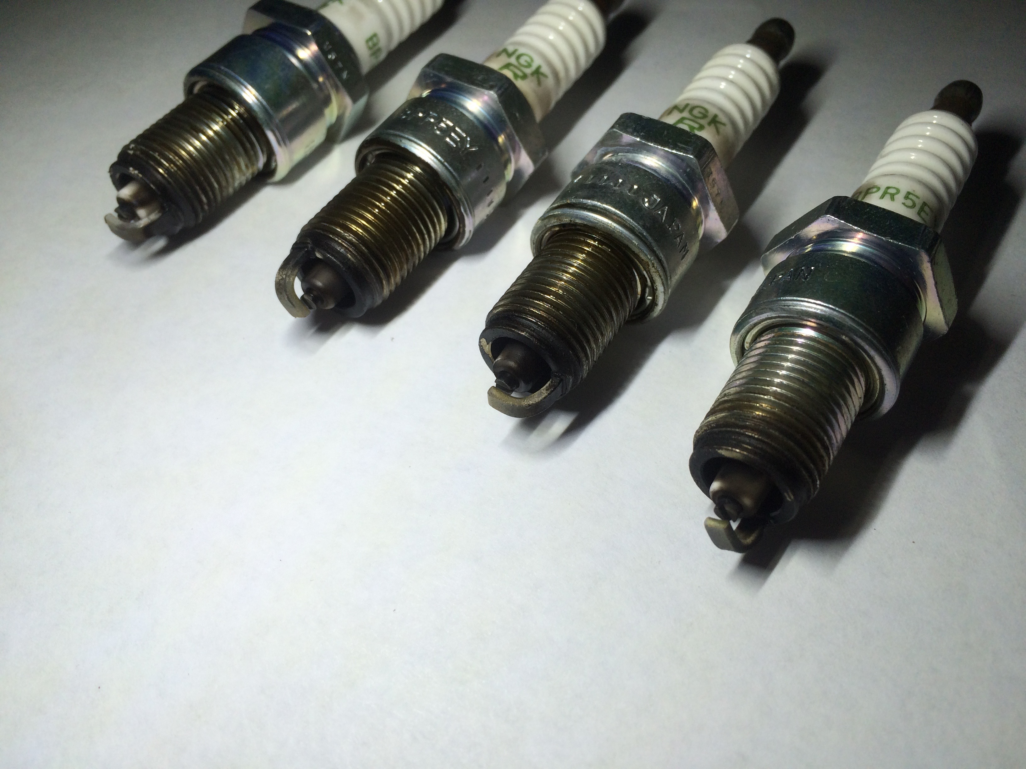

I also cheked a little switch in the IACV and resistance was to spec. Just did a cylinder leakage test and every thing checked out perfectly. When I pulled the valve cover off a little smoke was coming from the bottom of the case is that normal?
My plugs have some pretty good fouling it looks like. What could be the cause of this?

Ya those are rich. Your O2 may not be working. Also could be bad cold start injector timer or injector. My plugs are usually on the white end of the spectrum.
If you run the truck up to temperature then place a volt meter from negative to O2 pin in diagnostic plug you should see the voltege swing from around .4 volts to .8 volts. If it is not swinging back and forth your sensor is ng.

Edit: its interesting that plug #4 has less deposits than the rest. I haven't driven the truck enough to see if im burning oil

Plugs seem to be fouling weirdly with low miles and I have no black smoke like its super rich or blue from burning oil. What else could foul them ignition system or timing?
