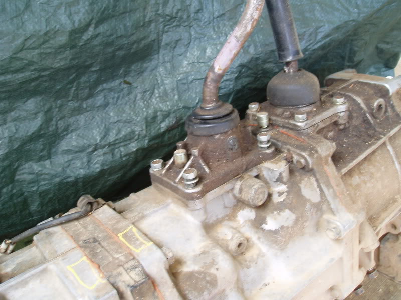

The sealing surface on the pinion could be damaged or worn to the point that the seal can no longer effectively seal. But what I have found is that with a new seal the lip needs some time to round/flatten itself down a bit to provide a better seal in some instances. With a new seal the lip of the seal is sharply pointed and has less surface area to create a good seal. So give it some time and it may well "fix" itself.
Your breathers should be in the same general area as these.
