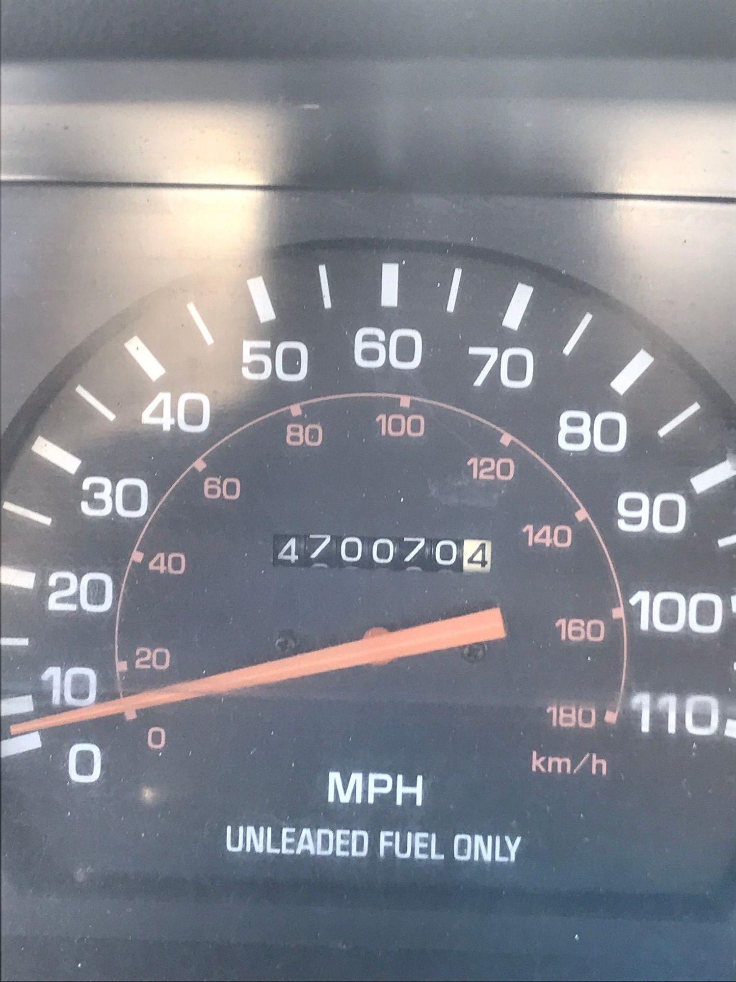

Been running 180 thermostat for 28 years original engine original transmission don’t want to change
I’ve been running after market for all these years never ran OEM 180 before it actually has 490,000 on it now Didn’t have a recent picture
