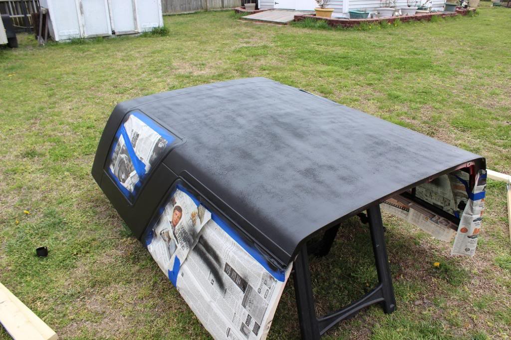

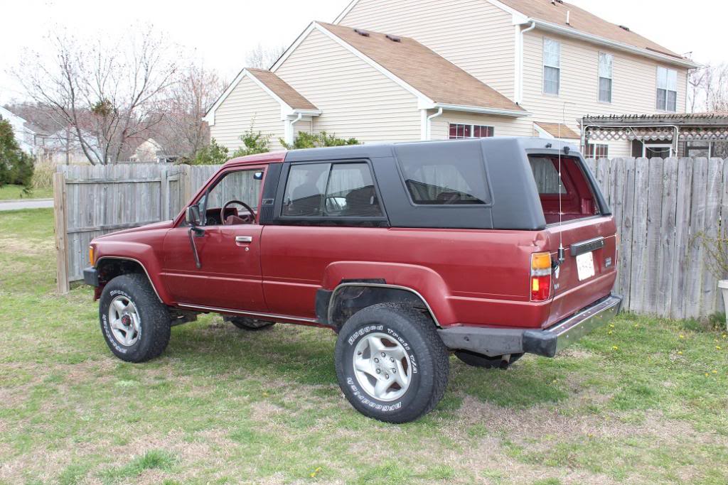

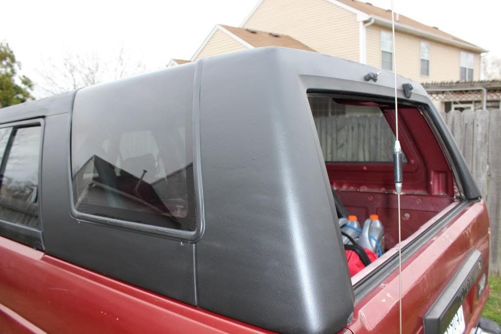

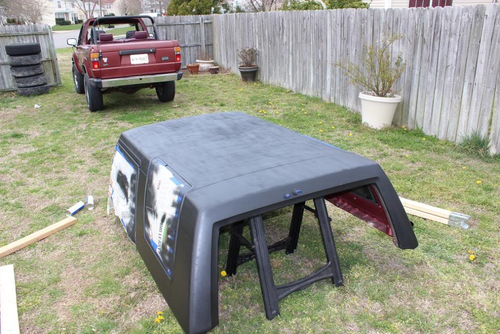

It really depends on the condition of the top. I used Duplicolor Spray on bed liner with mine with minimal prep. The fiberglass was starting to show on the top, I still need a second coat on the top, but for 20 bucks in materials it worked really well.
Here was before
During Refinishing
As you can see it still needs another coat on the top. But the top was pretty hammered.
Overall I am happy with it, it is cheap, effective and made a world of a difference to the look of the truck.
Eventually I plan on another recoat, then I am going to spray it with an HVLP gun and a quart of satin or gloss black single stage paint. I am just waiting on getting a soft top then I can work on the top a little more.
