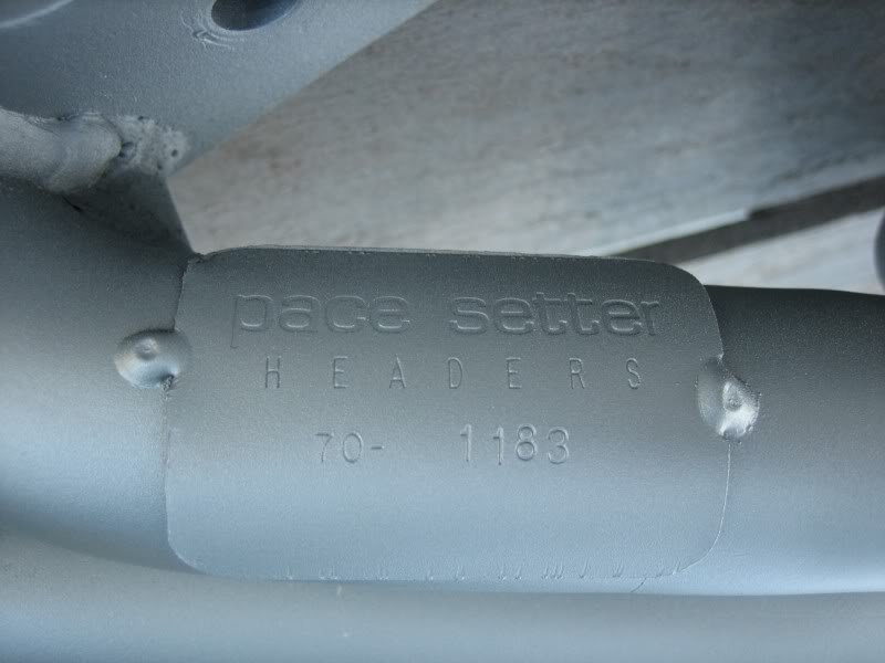

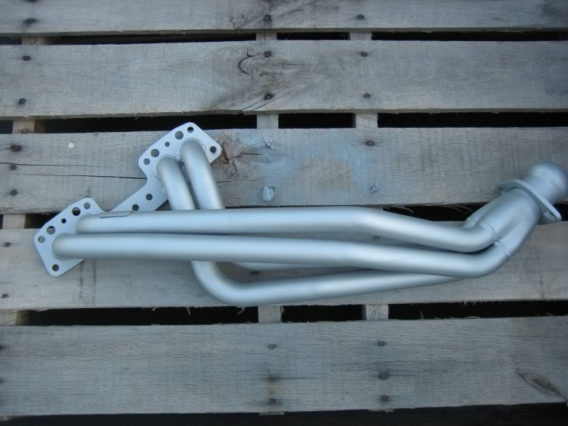

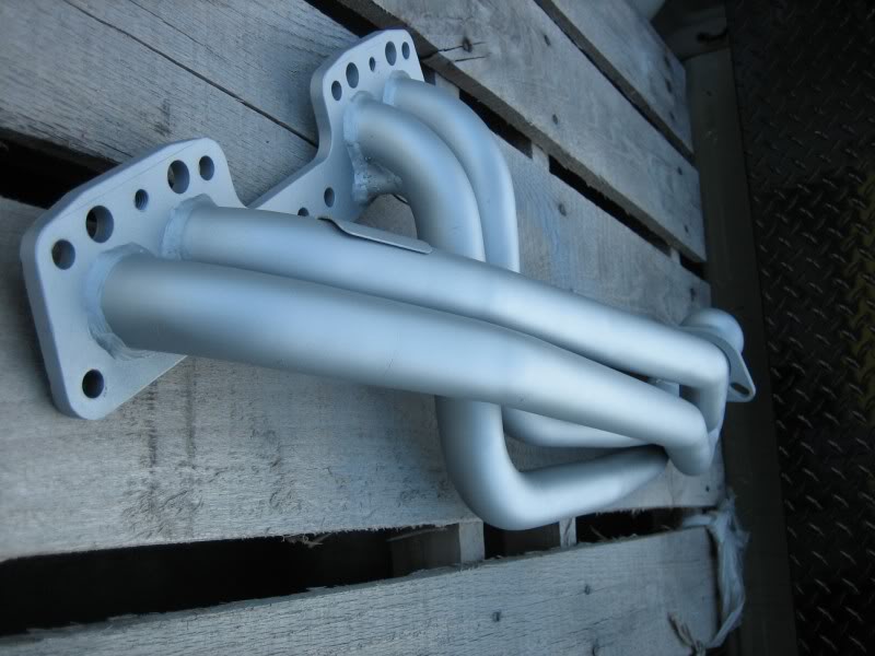

PaceSetter = CHEAP
plane and simple...
Looks good new:
Quickly goes to crap after 5 minutes of run-time:
But a sand and repaint CAN give it a second life
