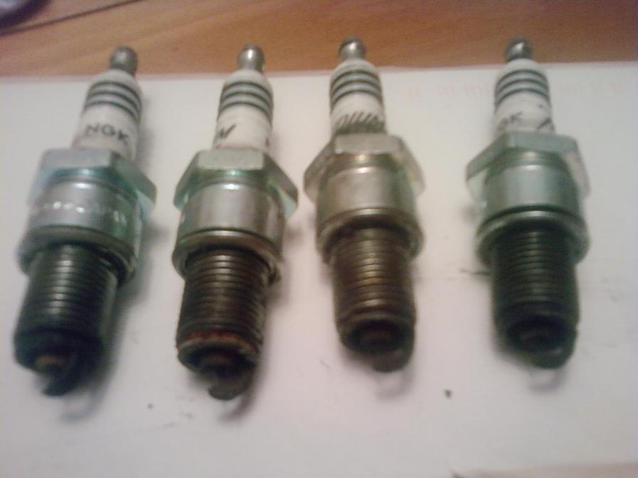

It appears that the number 2 cylinder is the one that has the problem but i included a picture of the plugs as well.

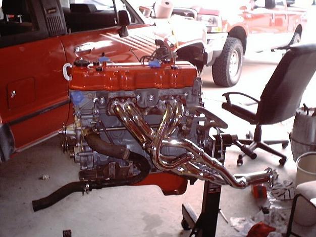

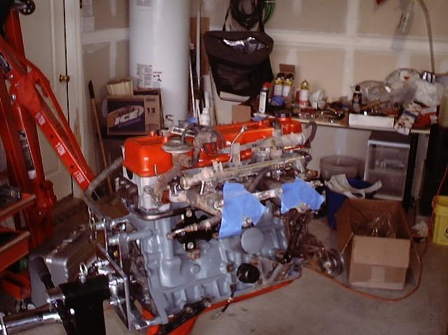

If you guys could help me as to what the problem could be I would very much appreciate your help as I am so financially tanked in this truck that I do not want it to go sit for another 3 years like it did last time i broke it. I will try to post some pics of it just cause.

The pictures of the motor are before I dropped it in, the spark plugs are from today
