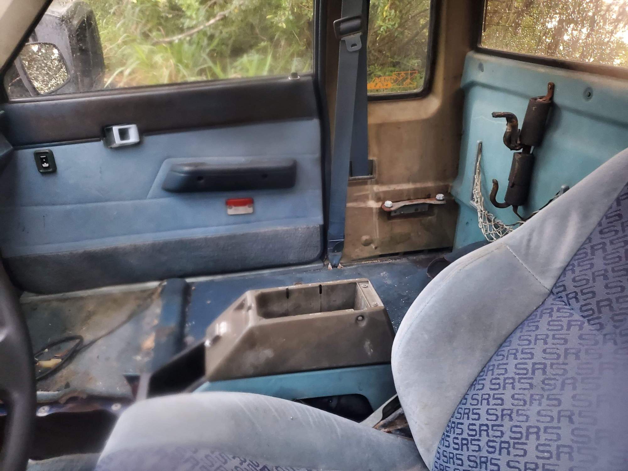

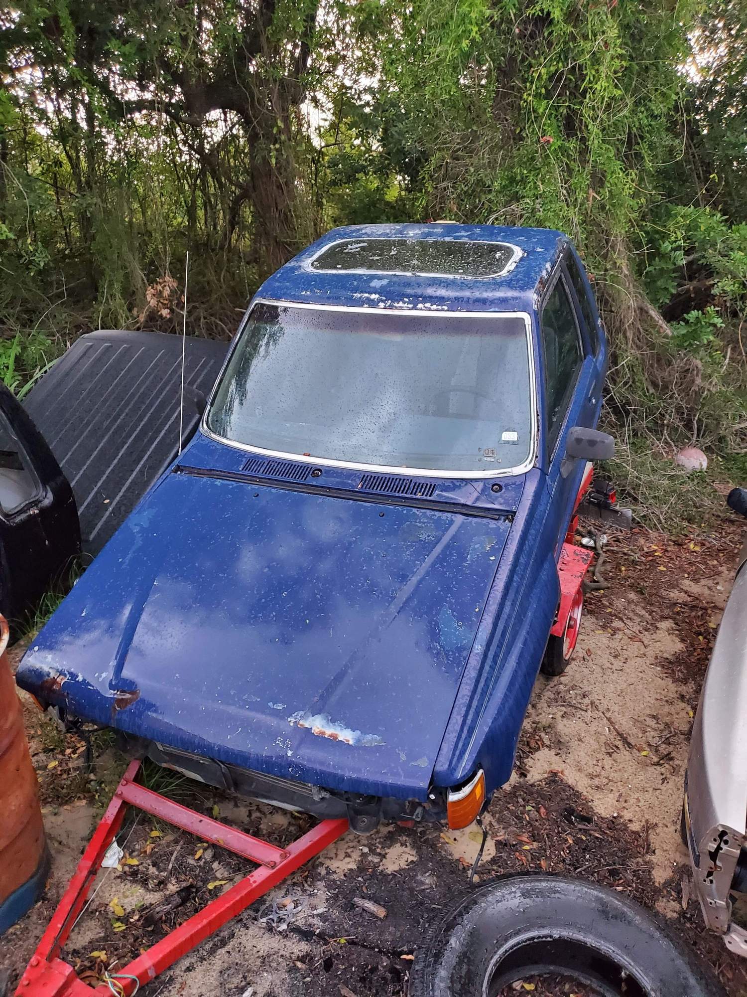

On a lighter note I'm picking up this sweet relatively rust free cab Sunday for 300$. Mine is so rusted it leans to the driver side lol the core support is a little bent but other than that and some small rust spots near the windshield shes miles ahead of my current cab pretty excited to dig in to this

Glad for the new, to you, cab! It LOOKS in good shape indeed.
A thought though: Pull the trim off and check the area right around the glass, where the glass is held in with the putty-like stuff, that I can't recall what is called. That is a known rust area. Apparently it holds water in that area, and allows rust to develop. I've even seen one person removed the trim and left it off. I'm not sure how, but he made it look like it came that way from the factory. Looks really good!
