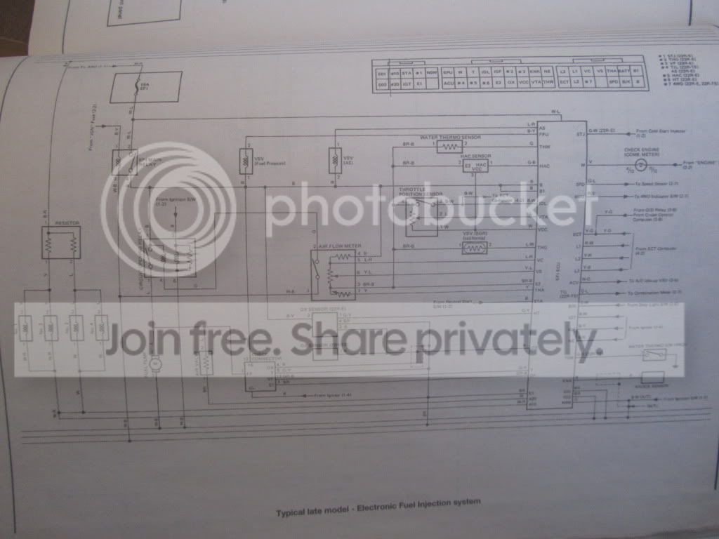

The fp +B jump would seem to rule out the AFM, but since it and the CSI wires affect starting suggests fuel system to me. Tricky, but I'd take a listen to the fuel pressure regulator on the injector rail with a section of tubing, and check system pressure if you're able. Also check resistance/continuity on the circuit opening relay and main EFI relay. The jumper cuts out most else involving fuel inj, here's a diagram-
Of course having solid clean grounds affects everything too...

Thanks for the diagram. Do you mean just take a purse of vacuumed hose and put it up to the regulator? Rail is getting fuel,don't know about pressure though. I took a bolt out of the side of the rail and cranked it and fuel poured out. I got it to run once for about a minute. The warmer the motoor gets the longer it runs but still wont run.

Im not to good with electrical, especially reading diagrams like that. Im open to any ideas right now, could the fuel filter be the problem? I have plenty of fuel to the rails but its just a hope. I might go change all my vacuum lines again, they are still new but maybe i can find a leak or something. Have had quite a few people over trying to think what it could be. Could the EGR have anything to do with it, also what is that other EGR looking thing kinda down and behind the EGR? Tried unplugging the TPS, also tried switching my efi and starter relay and there was no change, so that cant be it. spark plugs maybe? But it starts, just dies instantly so that doesnt seem plosible Someone has had to have the same problem and gotten an answer.
