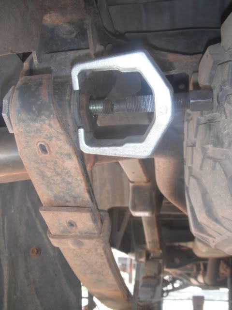

My handy-dandy pittman arm puller saved the day again...

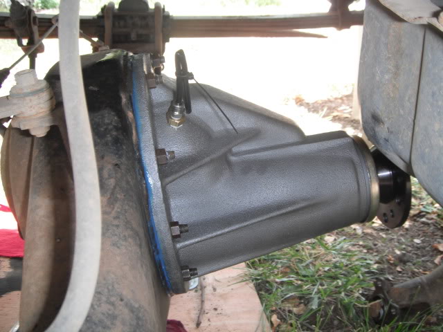

Installed Randy's Ring & Pinion built 4.88 3rd with Yukon zip-locker

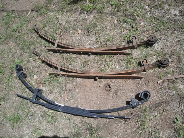

Old vs. New:

About 2.5 inches of lift, but my rears springs were completely shot. They ride really well, I could run the stiffer OME springs if I carried a pop-up camper or several hundred more pounds of gear.
The ride is much improved, much more compliant & stiffer on the road, which is more due to the shocks.

Truckmike-- Call Randy's & talk to them, they will probably price what you want lower than what they advertise it for. They gave me a SWEET deal on a rebuilt 4.88 IFS front diff. The customer service on the air locker has been awesome as well, they overnighted a new switch & solenoid because they were missing from my parts kit.
Oh yeah, and a Christmas card, signed by people at the shop & a nice calendar. Those guys rock.
