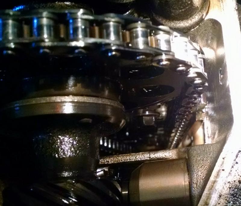

Old Dec 28, 2014 | 01:52 PM
Sandman's Avatar
Joined: Jun 2003
Posts: 128
Chain guide is there...

Old Dec 28, 2014 | 10:57 PM
muddpigg's Avatar
Joined: Mar 2007
Posts: 4,374
Likes: 37
From: Enterprise, AL
Check timing chain on passenger side that's where the tensioner is with a plastic guide (well if it hasn't been upgraded to metal). Tensioner lets chain slop which breaks the plastic guide chain eats through the timing chain cover.
Put a long screw driver down on chain to check for slop, might see broken guide if your lucky.
Old Dec 30, 2014 | 07:27 AM
Sandman's Avatar
Joined: Jun 2003
Posts: 128
both guides appear to be in place, wouldn't they have to be completely destroyed before the chain could get at the cover?
Old Dec 30, 2014 | 10:16 AM
muddpigg's Avatar
Joined: Mar 2007
Posts: 4,374
Likes: 37
IDK, could be but that's why I mentioned using a long screw driver to check chain for slop. Also could be the block cracked or HG. Maybe someone with more knowledge/experience than me will chime in.
Old Dec 30, 2014 | 11:04 AM
MAINETOY's Avatar
Joined: Jan 2010
Posts: 163
From: GORHAM,MAINE
22re oil in coolant
Wow from the pic it looks as if the guide on drivers side is broken off,it usually comes up further than that.Must be down in the pan now!
