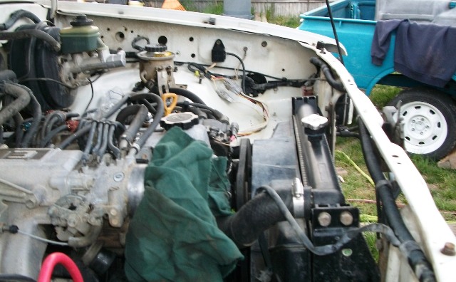

Help please folks, the subject is MAF sensor removal (the connector) I'm removing the airbox and everything else in that corner (stock vehicle).
Pulling the grill, washer bottle, overflow, lights..yada yada..
Seems Haynes doesn't remove this to do an engine rebuild?
As with all other mentions of MAF here, I don't want to break it, I just thought I'd remove it at the connector, and carefully bag it up until reassembly.
2 screw removal doesn't appear the correct method as it doesn't just slide out so I put it back in (lots of clean shiny parts inside) as an electronics guy I know what that means (don't unnecessarily mess with it) seems to be a disconnect with a wire clip going around the outside, not sure how or if to go that route.
That's where my request for help is.

Thanks for the info,
I just got a little chicken˟˟˟˟ strike in the process, so I asked,
but now I'm over it.
The 97 Tacoma I traded for the 06 Scion Box had the same thing.
Just didn't recall how to get into it. The clip flipped right off and away I went, back to the races..

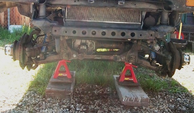

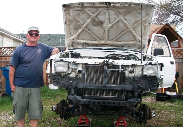

I'm going to pull and clean everything that doesn't involve a gasket, except the brakes,
they're already done, up and running, so why mess with it...
People destroy theirs by yanking at things, I don't yank!!
That's why mechanics get paid so much ...
I tore the whole unit down, full of San Diego dirt and sand, put it in a gallon freezer bag for the night.
I'll open the cover tomorrow indoors, with my magnifying lamp and denatured alcohol, not out in the yard.
I'll build you a computer or a cell phone, I'm used to clean small work, not filthy, goobered up auto parts..
Didn't realize I was going to have to Roundup under the truck
