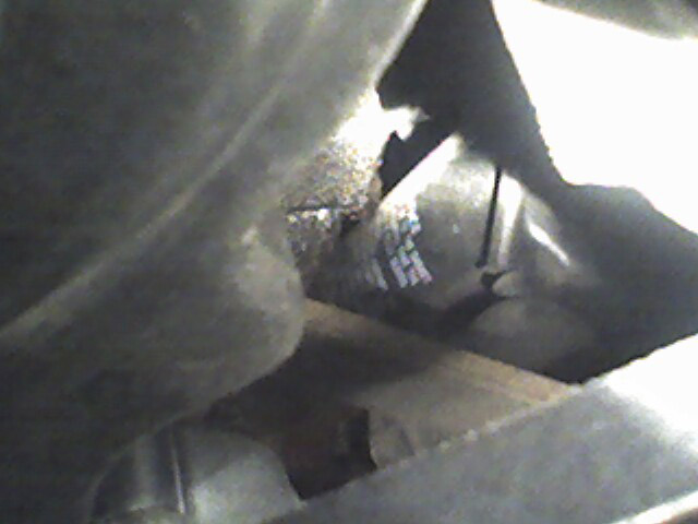

pics of the oil sender
I went outside to take some night shots of the oil filter and see if I notice anything out of the ordinary, and lo and behold there's a cable that looks like it got ripped off a connector. Here is a pic...it looks like it got stripped off, is this the oil guage sender? there isn't a lot of room to work...is this something that can be popped back on or does it need some serious labor to reattach it?

I'm sorry, but that pic is LESS than useless...
The sending unit is located immediately in front of the oil filter on the 3VZE. The wire comes down from the harness near the distributor.

Diddo on the picture. That almost hurt my eyes to look at.
If it is off the sensor, you can simply put an aligator clip on it to test it.

durn cellphones at night! sorry about the eyes guys. Eye damage is the last thing you deserve when trying to help. My evidently subpar photoshop skills also added to the damage
I will take a better shot with the 'real' camera later. the cable sitting on top of the oil filter is bent at an angle and simply holding on by a thread. I'm wondering if this will clip back into place or if I need to replace the whole assembly.
I'm attaching some originals w/o photoshop from the cellphone in the hopes that this will shed more light until I get a real camera in there.
in this pic the alternator belt is along the bottom, looking down towards the oil filter, with the bent cable lying along the top of the oil filter.

Tim look at your alternator then directly to the left of it...take the picture there
The sensor is usually under a big rubber cup type thing. (its in the email i sent you).
Old Jun 1, 2007 | 07:38 AM
Weasy2k's Avatar
Joined: Jun 2003
Posts: 943
From: Vancouver, Canada
OH yes that picture that you took the first time is the one...that wire you circled

thanks johnny! OK so that cable is the problem for sure. decision time- can I simply reattach this or do I need to purchase a part assembly? I wonder what a dealer would charge me to reattach this cable. I'm almost afraid to ask, but usually good for a laugh. low-cost solutions are definitely best

You'll need to unplug it and pull it out by the distributor & take a close look at it. If you can splice it, that's the way I'd go. The dealer is only going to want to replace the ENTIRE wiring harness (it's all one piece).

Tim tim tim! No no just look at it...get your hand in there and pull that boot up and see if the little wire is attached to the sender. If its completely broken then you have to worry about fixing it.
It prob just came off while driving it has happened to my dads 4runner several times.
